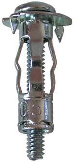

    use the dry wall molly.......best way in older car. !!!

    And get a plastic expanding one with #12 phillips panhead screw to hold on the plate...
