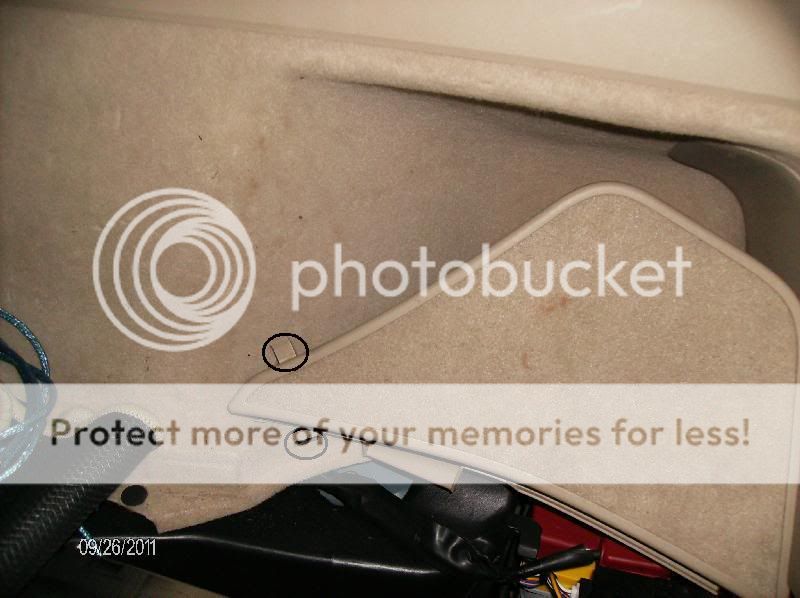

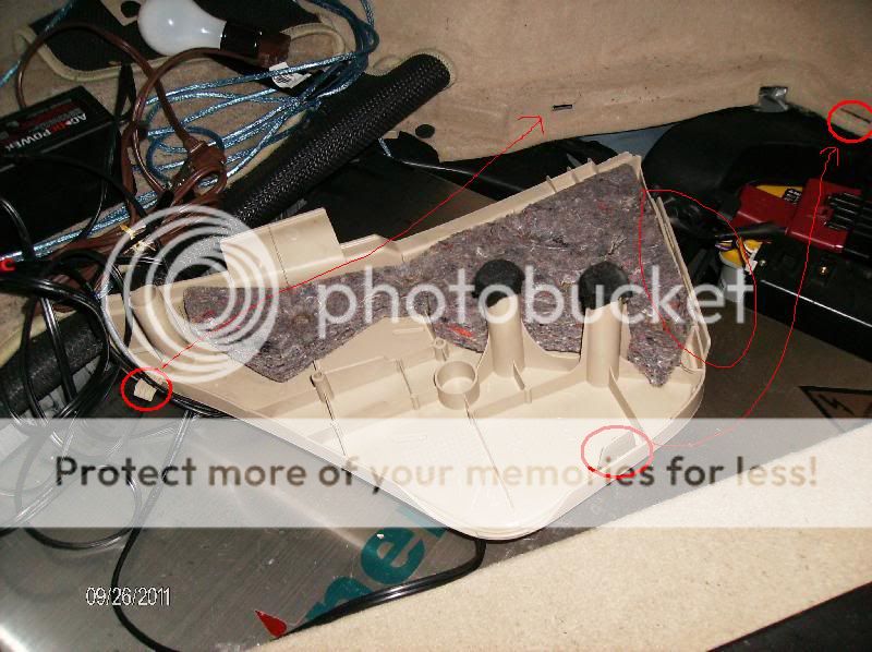

    Pictures? Did someone ask for pictures?
    #1. Push down gently on plate A to disengage tabs behind it; lift up at point B
    #2. Circled tab on left of cover goes into circled slot
    #3. Underside of cover. Tabs are circled and arrows point to slots they go into; bottom side of plate is circled where it connects to cover.

    Your post looks just like the info that I was hoping for & will try it tomorrow !
    Thanks !!
