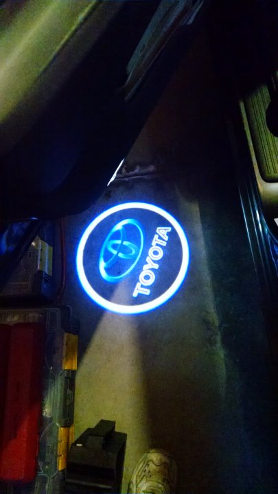

    Thin blade (…it doesn't need to be sharp! …it doesn't even need to be made of metal) …take care not to damage the locating tabs! - Good luck!
    Here's what I replaced mine with:

    Very cool! Where can I find it?

    I have that on my Prius Prime and I love how it looks!

    Amazon:
    Skibob and jerrymildred like this.
  8. Salamander_King
    Salamander_King Senior Member
    Nov 8, 2015
    11,019
    8,954
    New England
    Cool! Thanks. Not very expensive. Just wondering if this particular one fit on PRIME?
    Did you buy the same one as @WilDavis for your PRIME?

    Yes, I did

    It says 2010 and up (gen 3). What year car do you have them in?

    2009 Gen II…

    Thanks. Just wanted to make sure. Description says 2010 and up.
