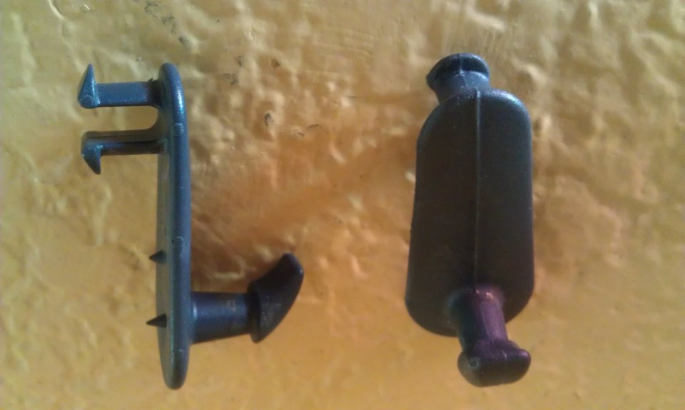

  5. bushpilot
    bushpilot New Member
    Nov 2, 2013
    Very simple! First unhook and separate the mat from the two hooks. Press the tail-end prong with a small flat head screwdriver - bend the hook-unit while unlatching the prong. It should pop out.
