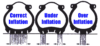

    If your tires are wearing evenly the handling and tire life are maximized at the cost of mileage and comfort.
    When I am adjusting my tires, I am shooting for even wear, good handling seem safest to me.
    If your tires are wearing on the out side edges, tire pressure is too low, good comfort at the cost of poor mileage, bad handling, and poor life.
    If you tires are wearing in the center, tire pressure is too high, good mileage at the cost of poor handling, comfort and tire life. Don't go here, you want tread on the pavement.
    (this picture is a gross oversimplification and over emphasizes how the tread will bend)
    I hesitate to put a number but I would start at 38f/36r and adjust as you see wear.

    Makes sense, Jimbo...
    I tried to open the picture you posted but it goes to Total Motorcycle site. Did you intend that?
