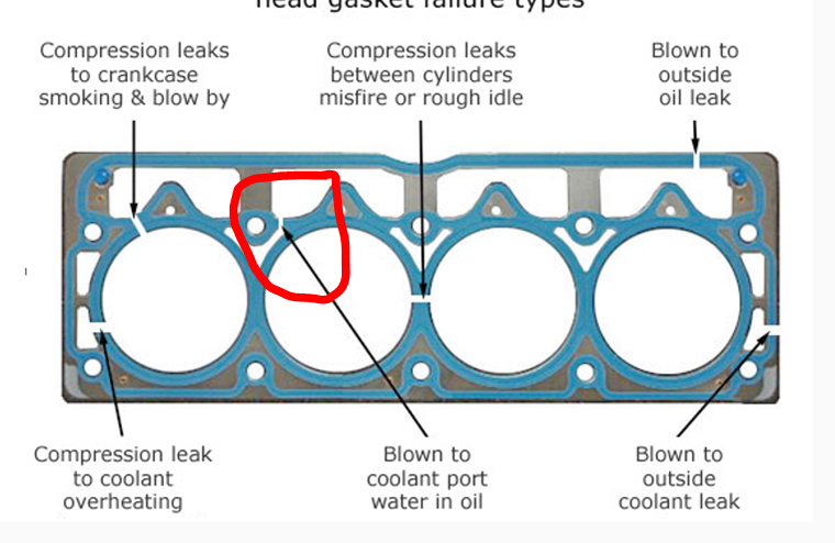

    So my 2010 is having cold start shakes and loosing coolant. I have cleaned the EGR system etc...
    I think its a blown head gasket as when I take the coolant cap off air pressure comes out and when I leave it off the car rarely shakes on startup. I found very faint white substance in the oil. This car has never burned oil so If this is coolant in the oil how is it getting there? is it going through the piston rings or is there a place in the head gasket that coolant and oil are close enough should there be a failure in the gasket they can mix? if so can some one provide an example pic so when I pull the head I can check? Also is there a procedure to check for bent rods? I would hate to do all this work only to find a bent rod down the road. side note I have only driven this car about a hundred mile since it started the cold start shake and I cleaned egr etc.. it has been parked since. Is this long enough time to bend a rod???

    Re-reading your question, I don't have a definitive answer. The cylinder head does contain both oil passages (to lubricate the cams and operate the VVT) and coolant passages (to cool it), and both pass through the head gasket from the block, but I don't know how likely it is to pass coolant directly between those passages. It is certainly common for coolant to leak into a cylinder, and from there, find its way into the crankcase.

    One of my favorite graphics: 6 different ways a head gasket can fail. Notice: Blown to coolant port, water in oil.

    Thanks half, my answer so looking at this I dont suspect its the piston rings as car never consumed or burned oil. My last conern now is a bent rod. I need to figure out how to check for that.

    Im guessing/hope my issue is here. but such a small amount its hardly noticeable in the oil but definately enough for a cold start shakes. In any case anyone's thoughts on the bent rod and how long it would take for damage like that to occur? that is my biggest concern it is the difference between doing this over the weekend or getting a 2016 engine and having he mechanic do a swap.

    found the answer and it is possible here.

    Yes what you show is possible(and might account for coolant in the oil). however if you have engine "shakes" (misfire ) on cold startup then it is fairly certain that you have coolant leakage into the cylinder. It can hydrolock and damage the rod anytime that the amount of liquid in the cylinder is equal or greater volume than the combustion chamber size at Top Dead Center. Might happen next month, or next week, or who knows.
