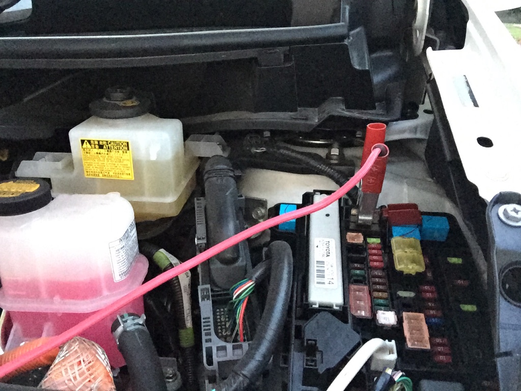

    I let the v sit for many months. No problems. Just kept a AGM battery charger on the jump points under the hood.

    jz,
    Where are the "under hood jump points"? I thought I'd read my owner's manual pretty well but failed to notice that, which is a pretty important point.

    It's in your owner's manual. At the back of the engine bay fuse box, covered with a red plastic cover is the positive terminal jump point. Negative is any good bolt or bracket nearby.

    Positive is like xliderider says. Pop the lid of the fuse box. There is a little red cover you flip open to access. The neg is a metal piece sticking out just to the bottom left, facing the car, of the engine cover.
    It is definitely in the manual. Sorry, I'm tired, it's dark outside, and I'm not very good at attaching photos....

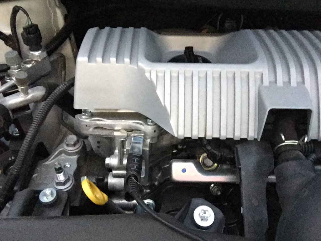

    I found I may have left the rear dome light on, for many days. Been out of town, too! Luckily it didn't die on my mother!
    [​IMG][​IMG]
    Don't forget it's AGM....
    iPad ?
    #15 jzchen, Jun 26, 2015
    bisco likes this.

    I don't think so. Had to take my cousin to have a surgery this morning so I didn't check. My mother drove it to work and back....
