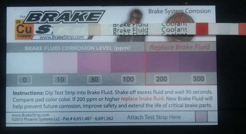

    I had a recent test result very similar to one reported by hobbit some years ago, both indicating this happens in the Prius surprisingly slowly.
    Test by hobbit at 110,xxx miles:
    Test by me at 145,xxx miles:
