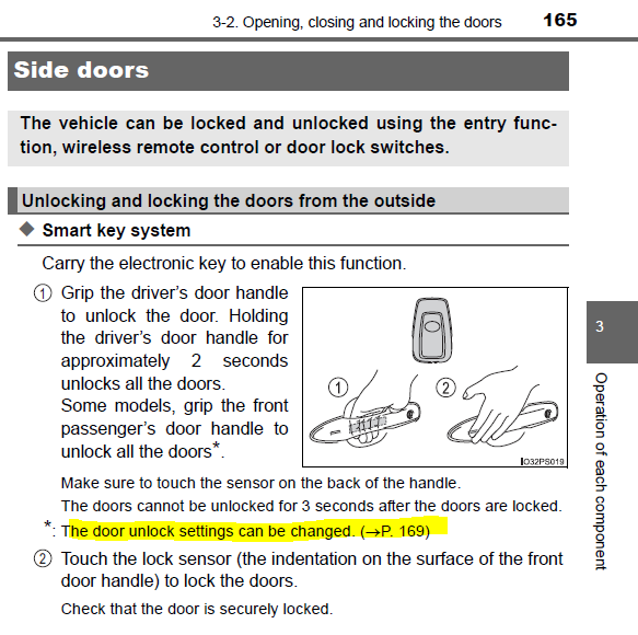

    From a pdf* of the 4th Gen Prius Owner's Manual, page 165:

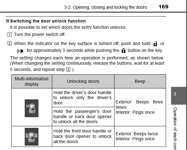

    Going to the highlighted link, page 169:

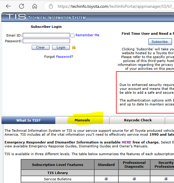

    * If you don't have a paper copy of the Owner's Manual, pdf can be downloaded from Toyota Tech Info website, in the "Manuals" tab:

    For your make and model; you've got only ONE touch sensor handle (driver's door). Higher trims has two, both front doors ONLY; I don't believe there's a trim where all four doors are touch sensitive; but I may be wrong.
    To access your trunk, you need to unlock all doors; press the FOB unlock button twice - all doors should unlock (3-beeps).

    that setting should unlock all the doors when you touch the drivers door handle. if you had a passenger, they would be able to get in after you unlock the drivers door.
    the setting for only the drivers door to unlock when you touch it is for security, so a stranger can't jump in from one of the other doors.

    See post #8. If you’ve got level 1, that’s how it is: driver-door only, touch to lock/unlock. The rest you’ve gotta use fob. You can still set the fob so one push of a button unlocks all the doors, per post #7.
