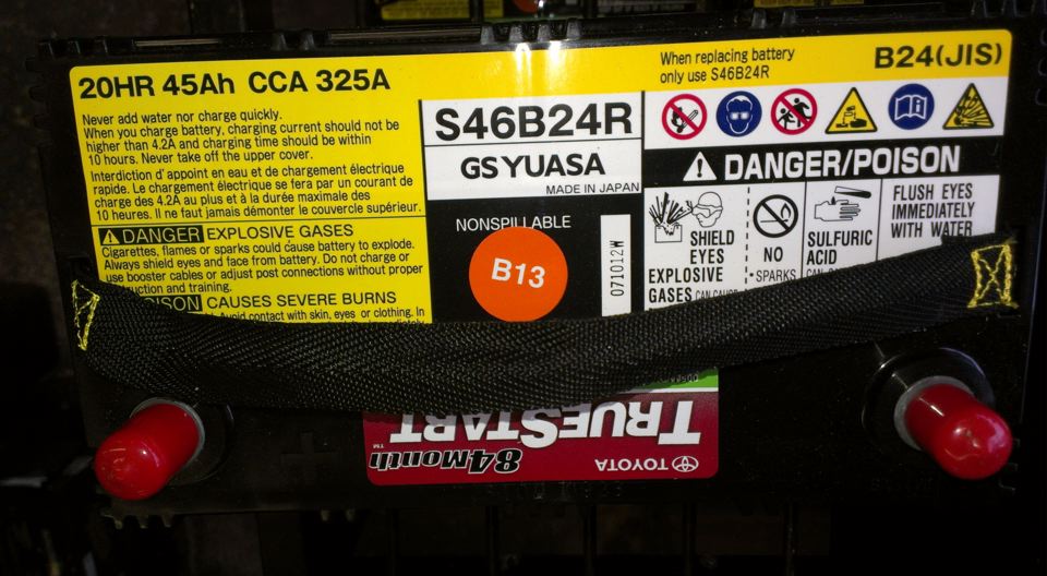

    This is what ours looks like. This was replaced by the dealer when the car was purchased (new); the car had been sitting on the lot too long, had toasted the orig battery:

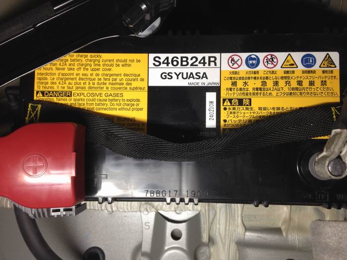

    And someone else here posted this pic, a while back:
    If you hook up a multi-meter, either at the battery posts or at the under hood jump start point, a 100% battery will be around 12.6 volt or higher. Anything lower than 12.5 volt you want to keep an eye on. Under 12.4 volt it's days are numbered.

    Well, for an update I now have ~117k miles on my prius. Never had an issue with the battery, never had to jump it. I did try to jump someone else's car and I think it is VERY hard to find a neutral on the prius hood (I could hardly find one for my multimeter... the metal is all painted). I let the car sit for several hours after I last drive it and I checked my battery today and it read 12.95v. I drove ~200 miles for work and then another 5 mi around town in the evening. I had hood open and all lights off, but I only waited a minute or so to test after lights were on. So, going by simple voltage, my battery is doing fine.
    Also, does anyone know if that number on the right under the GSYUASA is the date of manufacture? Mine reads 090509W. Judging by the other picture which had 240210W, I am guessing it is DD/MM/YY, so Feb 24, 2010? So my battery is May, 9, 2009? over 6 years old??
