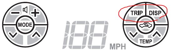

    Not sure with the 2015, but with mine: on the steering wheel buttons, push Trip first, then Display to cycle through the options. Per FuelMiser, set it to Trip A, or B.
    And yeah, it's inaccurate, take it with a grain of salt. Calculate as well if you want to accurately track how your doing.
    FWIW, I typically record the odometer reading at each fillup, rather than Trip A (or B). I do reset the trip meter at each fillup also, but just for insurance, and feedback as we're going through the tank. Any time you shut the car down, regardless of what's displayed, the odometer reading will display for about 30 seconds.
