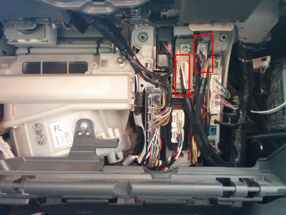

    actually I sold the car and forgot which ECU's are they, send a pic of the ECU's behind the glove box

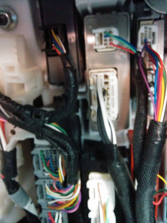

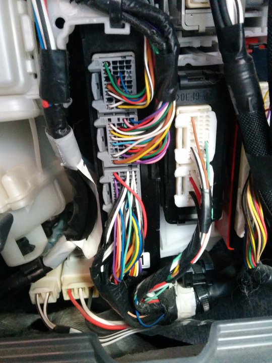

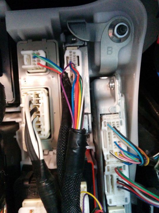

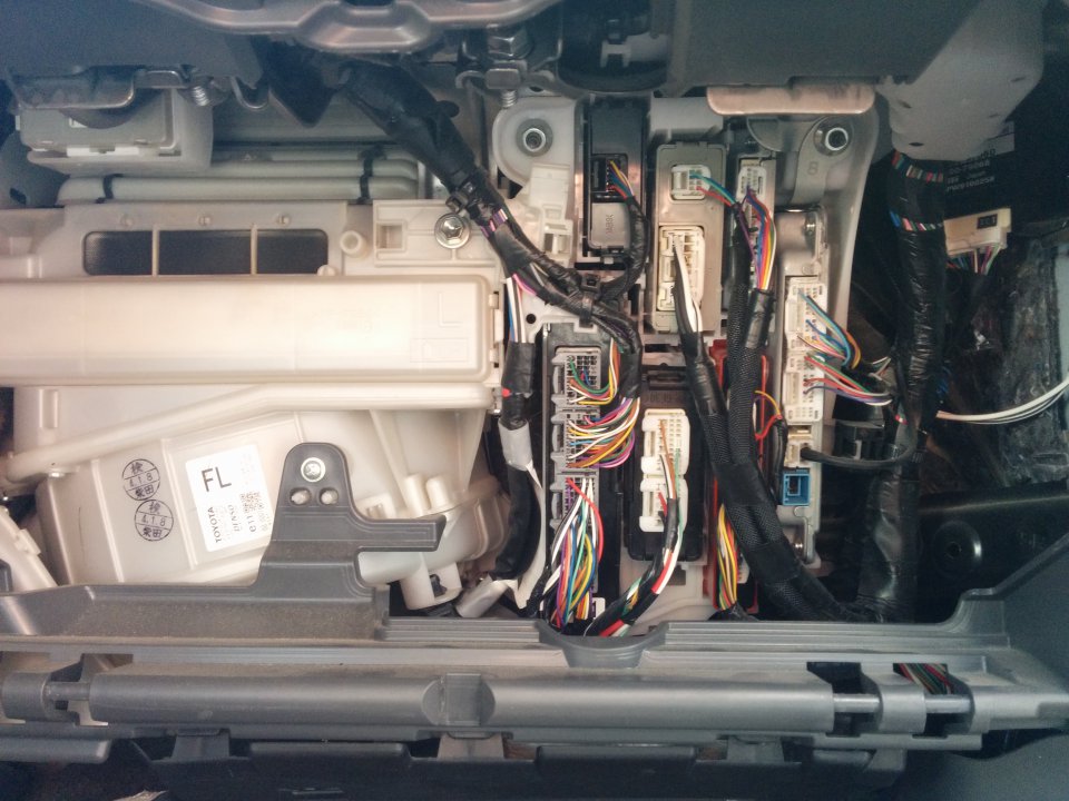

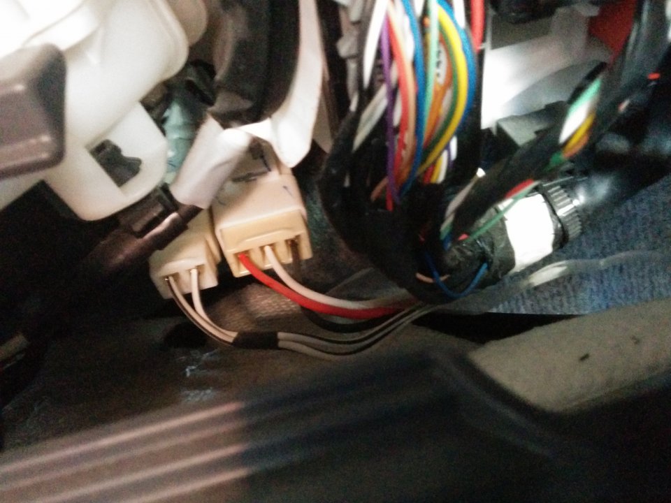

  11. ThomasSF
    ThomasSF Junior Member
    Oct 8, 2011
    Thanks for getting back to me, even after having sold the car!

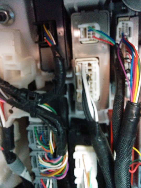

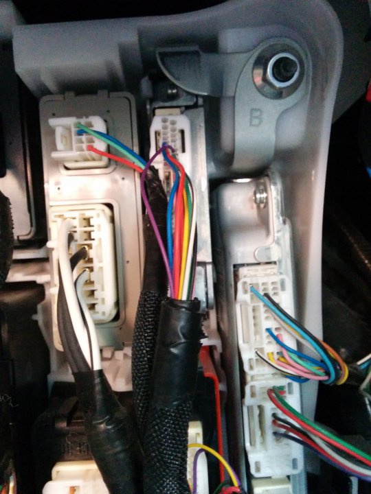

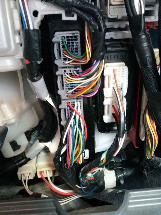

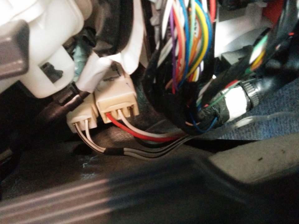

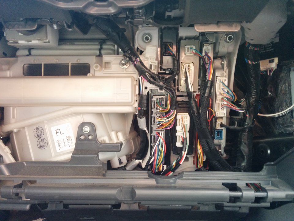

    So 2 days ago I said just **** it and started to arbitrarily pull out some ECUs. Not a good idea! Parking on a steep hill, the display eventually gave me a 'hand break error' and the car wouldn't no longer start. But after a few minutes, things were back to normal.
    So I just took a few pics. The first one is an overview, the remaining ones are detail shot. Hope you can remember them. Again, thanks a lot in advance for your help! Very much appreciated!
    Thomas

  12. AbuS3ood
    AbuS3ood Member
    Mar 4, 2010
    113
    Jordan
    unplug these two ECU's, this is what I remember, it will disable the normal cruise control as well.
    get back to me if I was incorrect.

  14. ThomasSF
    Oct 8, 2011
    IT WORKS!
    Been driving around with the warning for 2 years now… can't believe to see that silly animation again. :-D
    Thanks again for your help. Now I just need to tackle the headlights warning that came up 2 weeks ago…. ;-)
