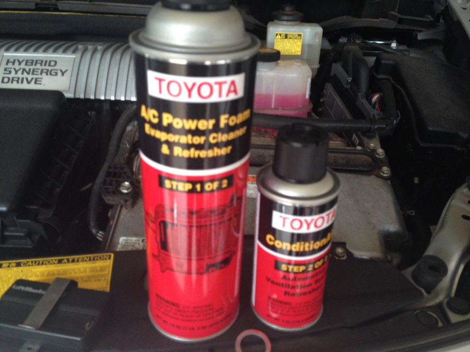

  16. ChapmanF
    26,217
    17,172
    The OP hasn't identified just what "foam cleaner" through the drain tube was tried already. The official cleaning setup from Toyota is a two-part deal where the first part is an up-the-drain-tube foam, so if that's the kit that was tried already, there's probably not much further to go on that front.
    If it was some other foam cleaner tried already, and not the Toyota kit, my next try would be the Toyota kit.

    Did anyone successfully get rid of the mildew smell this way? Lysol is magic for mold in most things. I'm glad I came across this thread, my car has a musty smell when you get in but seem to improve when the A/C is running. It's not terrible but it has that 'old car' smell going on…just when you get in, the ac helps the smell - what could it be?
    Did you try this or the Toyota kit? What about spraying lysol? I can’t imagine Lysol is that much different than the conditionaire bottle that comes with the Toyota kit.
