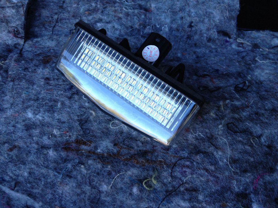

    I've done searches and only found how to replace just the license plate light bulbs, not the entire light assembly inside the hatch. I purchased the Xenon White 24-SMD LED License Plate Light Assembly from iJDMTOY.

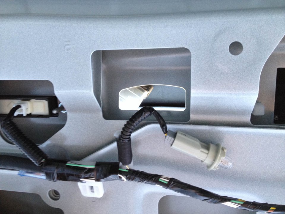

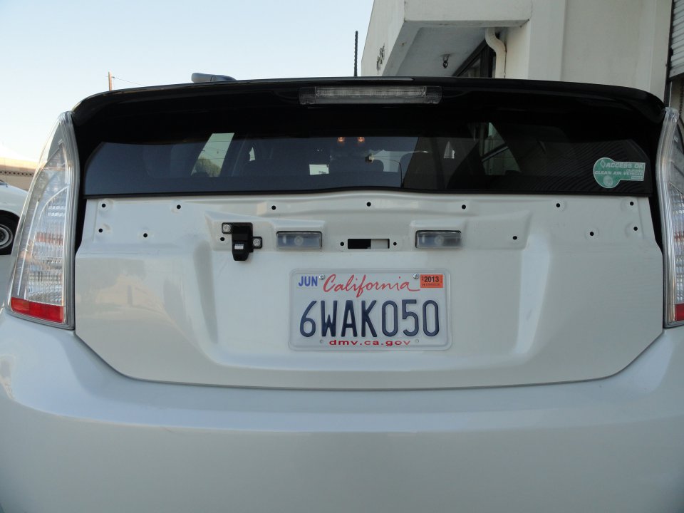

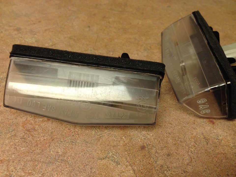

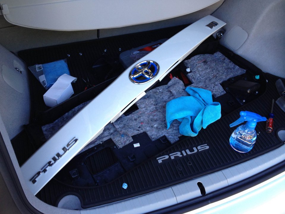

  5. RightOnTime
    RightOnTime Senior Member
    Sep 21, 2012
    754
    1,624
    183
    Kidnapped in OC, CA

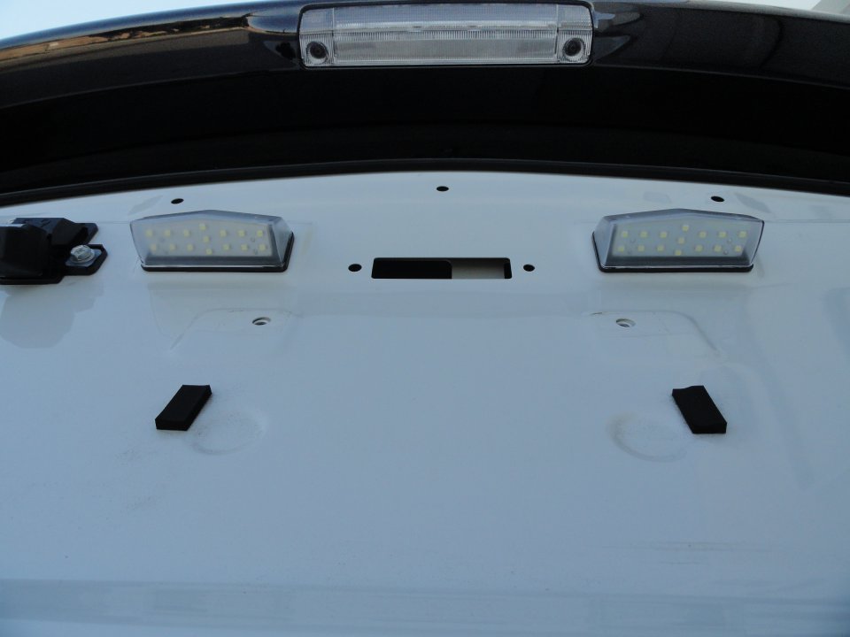

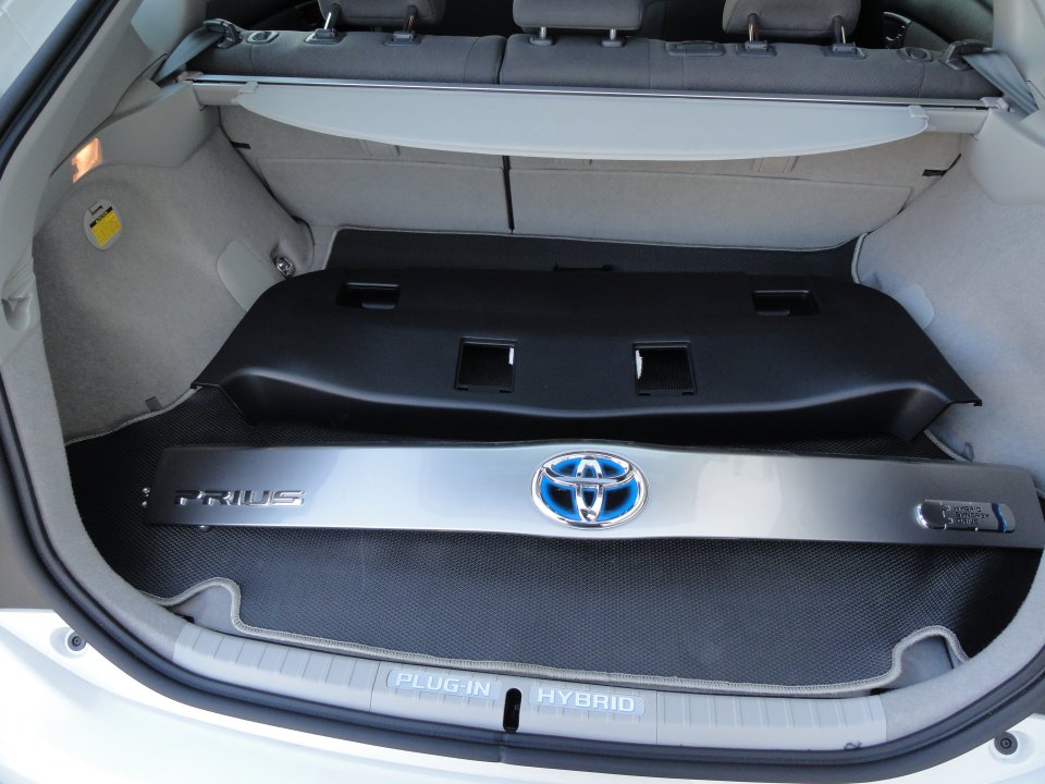

    Since i am a nice guy and want to help out the Prius Community..................
    1. Take off black panel inside the car. All held on by plastic clips (Designed to be pulled off and on)
    2. To remove the Rear Garnish, there are 4 nuts from the inside that you must remove (8mm)
    Once done, remove the Garnish which is also held on by plastic clips.
    Success!!! :):):):):):):):):):)
    3. Install new license plate lights.
    4. Repeat and rinse :D

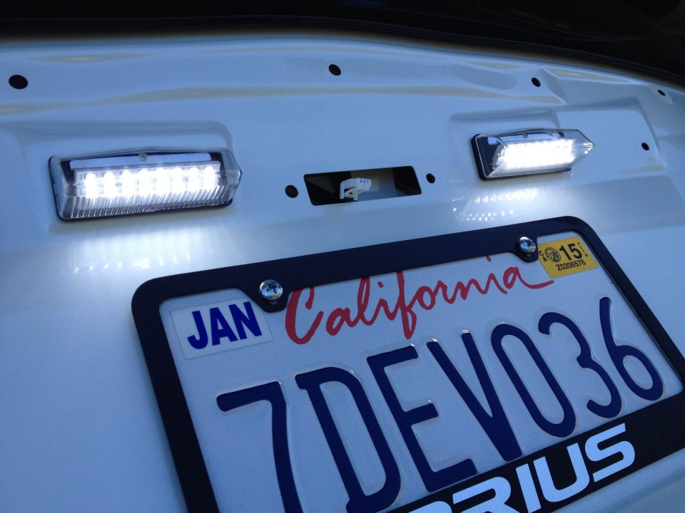

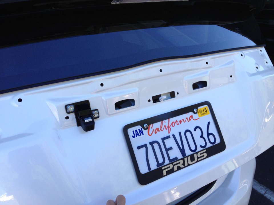

  8. slfare
    slfare Member
    Oct 5, 2013
    55
    133
    Portland, OR

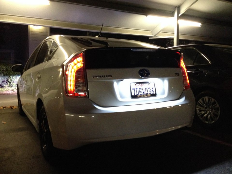

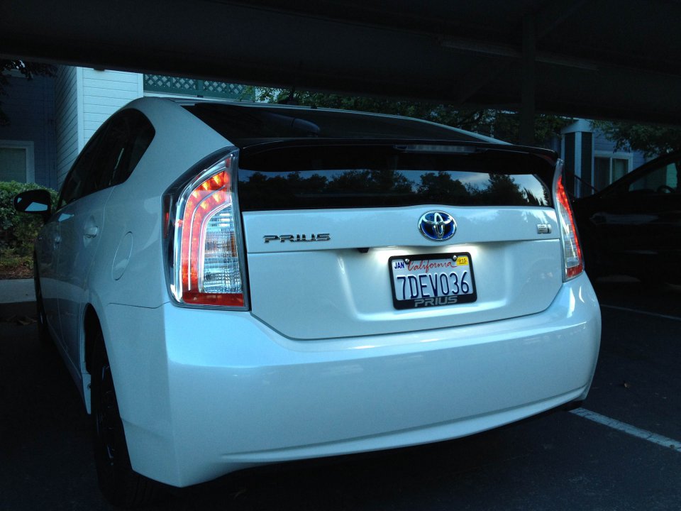

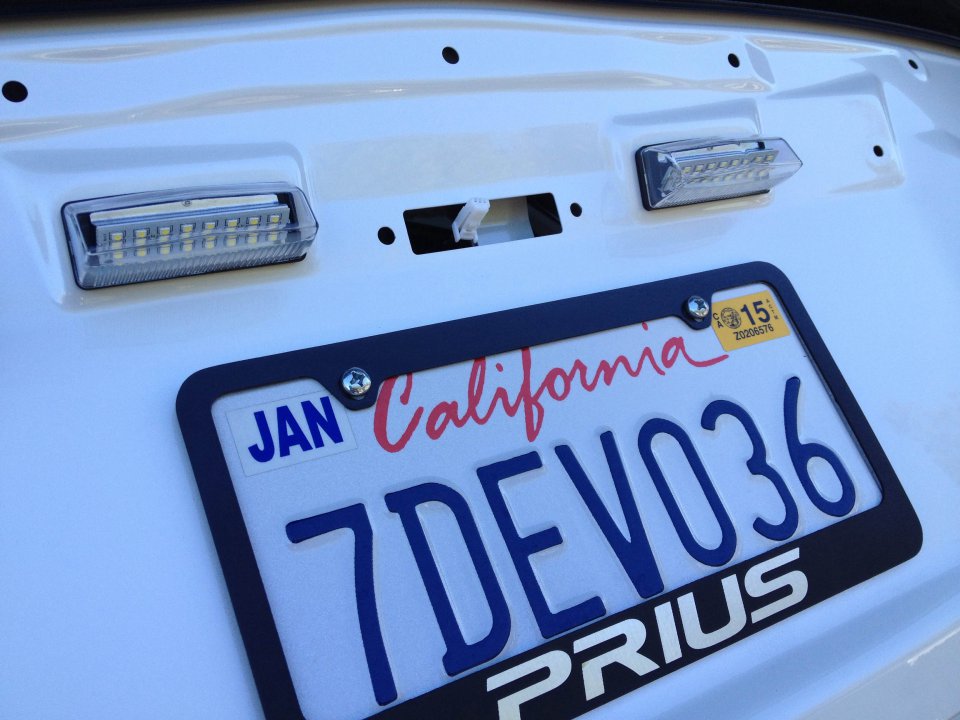

    RightOnTime, I couldn't have done it without your guidance. Thank you so very much, again. Pictures below. I am very happy with the results.
    Good riddance, OEM license plate light assembly.

    are they W A Y brighter than the stock ones or just a little bit with a different light color?

    Yes, they are W A Y brighter than OEM.
    It looks nice.
