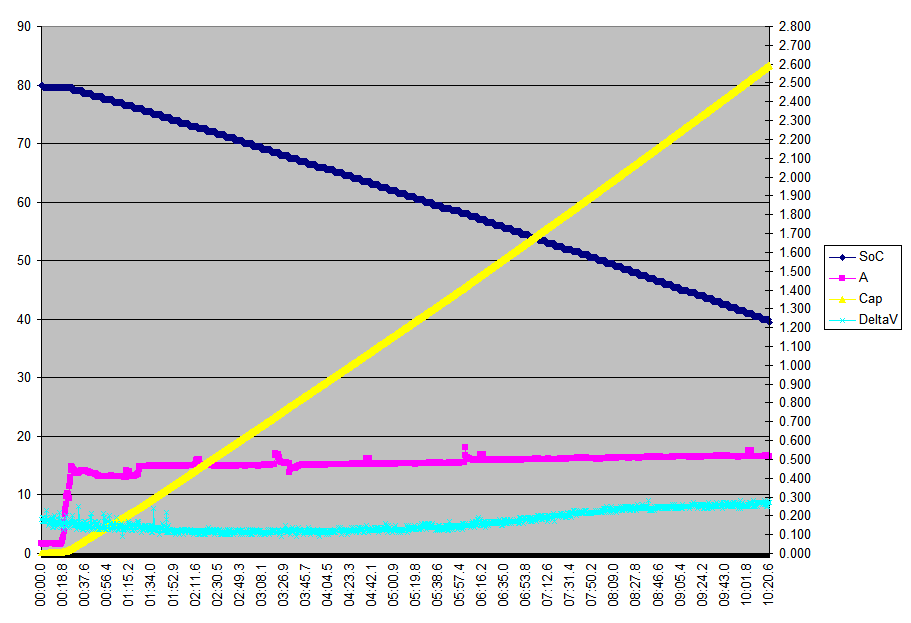

    There are a few recommendations on here concerning the subject. I have developed a method using Techstream that I feel can apply to anyone with no diagnostic equipment at all.
    NOTE: this test has only been verified to work at or above 70°F. I will repeat this test at progressively lower temperatures to determine effectiveness. Additionally, I will devise a "no A/C" multiple for use in colder climates.
    Proceed as follows:
    1. Read and understand all steps before starting.
    2. Test should be initiated when ICE is completely cold.
    3. Access the 12V and disconnect the large white plug. Wait 60 seconds and reinstall. This erases the Battery ECU's current SoC approximation.
    4. Start car. Allow it to charge at idle. Once it stops charging at idle, force charge as follows:
    5. Force charge to 80% SoC (parking brake on, smash and hold brake, in "D", floor the throttle until all green bars and charging arrow is blinking on and off). NOTE: in some cases, the car may refuse to charge above 7 bars. It's normal. Terminate force charge if you experience this. The 12V reset in step 3 should prevent or minimize this occurrence.
    6. Set A/C to lowest temperature setting, max fan speed, fresh air intake. The goal is to make the compressor pull the highest load possible.
    7. Rear defroster on
    8. Low beams on
    9. Parking brake on as hard as you can press it AND chock the wheels if possible.
    10. in "R"
    11. Release foot brake (parking brake always on, confirm you don't roll), do NOT apply throttle.
    Do 6-11 as quickly as possible and start a timer. Record the amount of time it takes before the ICE starts (should happen when you have 1-2 purple bars, but it may not be immediate). On occasion the ICE will start momentarily and shut off. A few of these will not influence the test. This actually has a net draw down of SoC as spinning the ICE takes more current than any regen you get from the ICE.
    Once the ICE restarts in the 40% SoC area, shut down A/C, defroster, lights and put in park. Allow the car to charge normally at idle.
    After the test is completed, I recommend you drive normally until the SoC gauge returns to six blue bars or for 10 minutes, whichever is longer. In hotter climates, the cycle can leave the battery pretty warm.
    Convert the # of minutes:seconds to decimal form and multiply by 9.5%
    The result will be your battery state of health, i.e., the % of rated capacity.
    While "9.5%" precision indicates this might be a precise measurement, it's not. It's what my car produced under Techstream monitoring, so YMMV. I would expect a variance on the order of ±10%, so if you come back with 103% SoC, it's probable your compressor consumes a little less current than mine, and your battery is probably very healthy.
    My car with a "like-new" performing battery (2600mAh usable capacity) is the baseline for this test. These results have been confirmed on an '06 with 130K miles and a second '06 with 154K miles with current/capacity measured by Techstream.
    Here is what I capture with Techstream:
    I recommend a reduced data set for faster sampling. The above can be saved as you create it.
    I'm not familiar enough with the Gen 3 display to say how it will work, but I expect it will. I haven't confirmed the process as currents might be different, but a trusting coworker will likely let me test it on her car.
    Here's a plot of the Techstream output:
    Computed capacity was 2,594mAh (2,600 is 40% of 6500). The current was 15-16A and deltaV stayed under 0.3V even at 40% SoC.
    This battery is a low mileage pack from a mild climate and had been tested on a module level. All modules met very near rated capacity within 5% - some over, some under.

    You did not conduct the test as instructed. It does not appear your A/C was on at all. A/C to fresh air, "LO" temp and rear defroster are key to the success of this test. Your peak current was in the vicinity of 6A instead of the 16A the test should produce. Here is the output of your Techstream chart:
    The little spikes are around 10A, the top of the green hump is about 6A and the bottom is about 4A. Your average is about 5A or 1/3 the desired current. Note how the blue line abruptly drops off. This should be a fairly uniform drop as in the chart at the top. The abrupt drop off is indicative of a severely deteriorated battery. I don't have the numbers computed but your battery is at approximately 30% SoH and is likely to continue to deteriorate to the point of failure in the very near future. You have almost no usable capacity left, and 60% SoC is in the steep part of the blue curve meaning the SoC swings are likely to be high and your voltage drop with load is severe.
    I invite you to repeat the test as instructed making sure your A/C is on Fresh inlet, "LO" temp and rear defroster is on. A local PC member contacted me to help with his grid charge installation. We ran a test. His output is as follows:
    As you can see, the current (green) is pretty steady. At the point the SoC starts to drop abruptly, current is 16.04A and deltaV is about 0.24V.
    The encouraging thing about both of those tests is the deltaV is relatively tight. This suggests uniform deterioration of the modules and are excellent candidates for reconditioning through grid charging/discharging.

    Here is an Excel plot of your data. I trimmed the data at the beginning and end to eliminate extraneous data:
    Things of note:
    1. The SoC line falling off rather than a gradual, near constant-slope line is an indication of significant deterioration. I highlighted the region in red between 55 and 65% SoC. Note how the bulk of that region encompasses the steeper part of the blue curve. This indicates that your assist is severely limited as voltage drops occur quickly in that zone. The car registers this as a SoC drop and you likely will see amplified gauge movement.
    2. Your DeltaV remains very tight throughout the range. This is a signal that the deterioration is uniform and not associated with a single block.
    3. Your average current was low at 5.6A. Under the prescribed 15-16A load or car loads, these would both be exaggerated.
    I have also attached the source Excel file. The computed capacity was 999mAh from 81.5% to 39.5% SoC. 100% SoH is 2730mAh at that range, so your SoH is 999/2730 = 36.6%. I regard this as optimistic because your average current was 5.6A, which is approximately 1/3 the 15-16A load the test should produce.
    Your battery is definitely near its end of life; however, it is likely a perfect candidate for reconditioning via the Prolong grid charging equipment/process.
