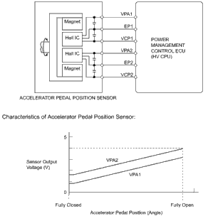

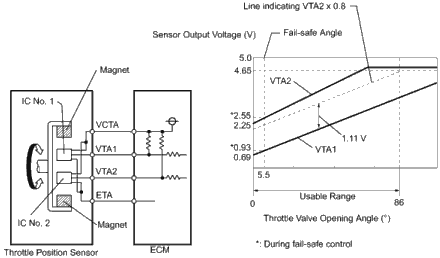

    To keep things clear for any future readers who might land on this thread:
    The car has both a throttle position sensor (under the hood, connected to the throttle) and a pedal position sensor (under the dash, connected to the pedal).
    The two sensors are independent.
    The pedal and the throttle are independent ("drive by wire"). Pushing the pedal doesn't directly move the throttle at all. The pedal sensor is an input to the power management control ECU. The ECU decides how much power the driver wants, how much to use the battery for, and how much to use the engine for. It notifies the ECM of the wanted engine power, and the ECM decides how much to open the throttle.
    The two sensors are similarly built. For redundancy, each one has two separate Hall sensors and produces two separate output voltages.
    For the pedal sensor, those are called VPA1 and VPA2, and they go to the power management control ECU.
    For the throttle sensor, they are called VTA1 and VTA2, and they go to the ECM.
    To better detect malfunctions for safety, each sensor's two output voltages are not identical. Each sensor's two output voltages track each other, but one is higher by a certain specified voltage. The car's firmware checks both signals for having the right mathematical relationship to each other, and will log a code and enter a failsafe mode if they don't.
    You can see the pedal sensor is a bit more strictly redundant. The throttle sensor shares one power and one ground for both of its Hall sensors, but in the pedal sensor, each Hall chip even gets its own separate power and ground.
    Toyota really does not want any pedal sensor malfunctions giving wrong input about the driver's intentions.
    The trouble code situation is very confusing. Codes P0120, P0121, P0122, P0123, P0220, P0222, P0223, and P2135 pertain to the throttle position sensor. Codes P2120, P2121, P2122, P2123, P2125, P2126, P2127, P2128, and P2138 pertain to the pedal position sensor. You can see these ranges overlap weirdly, so the similar looking P2135 and P2138 codes are codes about completely different sensors and come from different ECUs.
    Scan tools that identify the source of a trouble code are helpful. If you are using something like Techstream, or the Car Scanner phone app, where it not only shows trouble codes but also which ECU each code came from, you'll see that any P2120, P2121, P2122, P2123, P2125, P2126, P2127, P2128, or P2138 came from the power management control ECU (so it's about the pedal sensor), or that any P0120, P0121, P0122, P0123, P0220, P0222, P0223, or P2135 came from the ECM (so it's about the throttle sensor).
    The fortune cookies for the codes are just as confusing as the codes themselves. All of the above codes have fortune cookies that look like "Throttle / Pedal Position Sensor" something something. They don't identify one or the other.
    That's because all of these codes are in the P0 or P2 ranges that are standardized by SAE, so they use more generic language than Toyota could have used in a manufacturer-defined range.
    So SAE defined a list of standard codes for "throttle" or "pedal" position sensors having different circuits named A, B, C, D, E, etc. Toyota decided to use "A circuit" and "B circuit" to mean VTA1 and VTA2 (the throttle sensor signals), and "D circuit" and "E circuit" to mean VPA1 and VPA2 (the pedal sensor signals). Hence the confusing names.
    Upthread here, jdjd reported a P2135 code, and tak1313 gave the correct information that P2135 is about the throttle sensor (under the hood), not the pedal sensor (under the dash). But jdjd replaced the pedal anyway, and reported an apparent improvement.
    That kind of thing does happen amusingly often in a forum. There's usually a reason why replacing the wrong thing led to an apparent improvement, and in some cases the reason eventually comes to light, and in others it never does. But future readers can save some time and effort by paying careful attention to which codes have to do with which sensor.

  18. ChapmanF
    26,366
    17,271
    That's not even quite it. P2135 and P2138 are both correlation codes. What P2135 means for the throttle sensor is exactly what P2138 means for the pedal sensor.
    Each of these sensors, for safety redundancy, makes two different voltage outputs. For the throttle sensor, those are VTA1 and VTA2. They are supposed to track each other, like this:
    If they don't, you get the P2135 code. It's about failed correlation between VTA1 and VTA2, which are both from the throttle sensor. (Shoehorning the check into the SAE standard codes, Toyota picked P2135, which is about correlation between voltage "A" and voltage "B".)
    For the pedal sensor, its two outputs are VPA1 and VPA2, and they are supposed to track each other, like this:
    If they don't, you get the P2138 code. It's about failed correlation between VPA1 and VPA2, which are both from the pedal sensor. (Shoehorning the check into the SAE standard codes, Toyota picked P2138, which is about correlation between voltage "D" and voltage "E".)
    There isn't any code comparing an "expected position of the throttle" to the pedal position. Because the system is drive-by-wire (and the engine is only one source of driving power, and the ECU decides how much to use it), there isn't any simple "expected position of the throttle" based on the pedal position.
