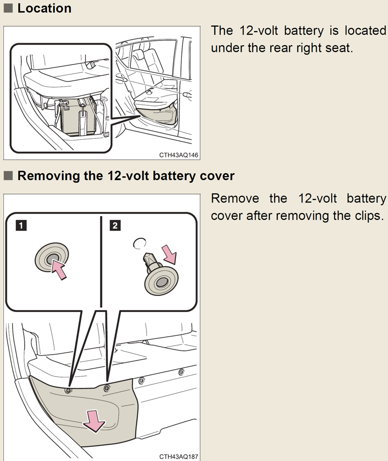

    This image shows the terrific job done by the Toyota engineers fitting both the HV and 12 V battery, but also the gas tank (shrunk to 36 l from 42 in the Yaris). All that is encaged by metal protections to protect from side impacts.

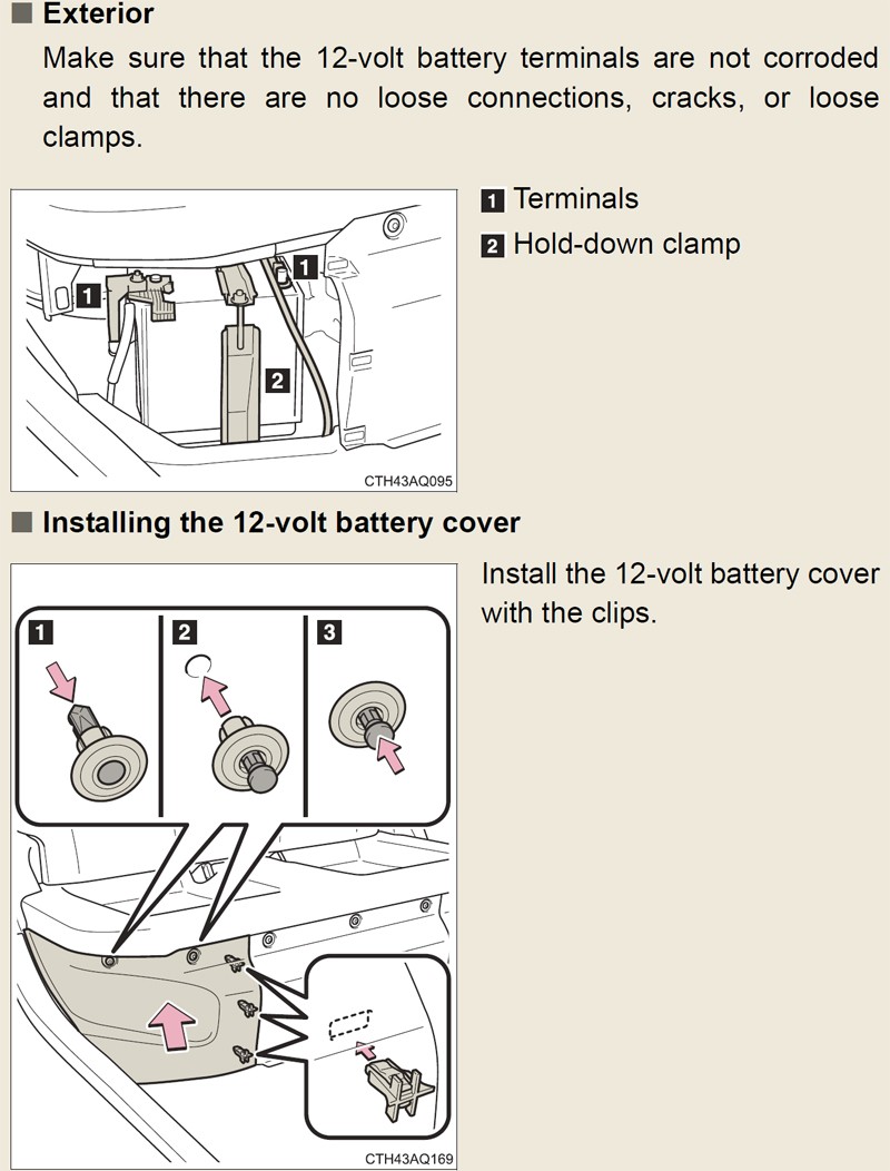

    The 12 V battery is accessible through a removable cover
    Nice job and worth noting!

    The metal cage also serves as the support for the rear seats. Very clever packaging.

    The accessories -lights, stereo, etc - are powered @12v as well as the start button. There is a voltage converter to recharge the 12V battery. Because it is sealed to be inside the car it is much more expensive to replace even though it has a much lower load than a normal 12V car battery.
    I'm surprised they didn't find some room under the hood for a less expensive part. That would give normal jump points, so I wouldn't have had to read my manual and hunted with a flashlight when mine died. Does anyone know why its under the seat and not under the hood in the c? I understand it may be for weight balance in the lift back.
