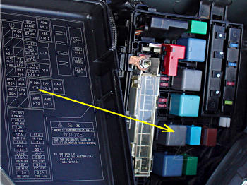

    Sorry to revive this thread again folks!!
    I have a 2007 UK spec Prius that I bought flood damaged. It hasn't been repaired as yet but I need to get the pawl off so I can move the car around the yard by pushing/towing it.
    The car can get power by connecting the 12v battery. When it's connected the alarm comes on immediately and car seems to be immobilised. Pressing the power button once with the key in turns the light green and a few normal warning lights come in the display - parking brake on, ABS light etc. When pressed again the light turns red but everything else lights up - odometer, trip clock etc. The 4x gear selection mode lights in the cluster all illuminate but are flashing. When I move the gear lever it has no effect and the car will not come out of park no matter what I do.
    On another prius forum it says to remove a 30amp fuse labelled "PCON" which is located 2nd one down under the long white plastic box with transparent lid in the fuse/relay box under the bonnet - but mine has a 25amp fuse here labelled ABS-1 (perhaps this is because mine is a UK car??) Anyway, removing this makes no difference. I have also tried removing the 30amp relay labelled PCON and all other fuses labelled PCON but no difference - the front wheels remain locked to the ground.
    All I want to do is disable the pawl so I can shift the car around - please help!!!

    Removing PCON only stops the car from moving the pawl, so you can shut the car down while leaving it in neutral. The pawl needs power to move in either direction.
    If the pawl's engaged, and the system is refusing to let you shift into N, you'll need to mechanically disengage it. I seem to recall that there's a procedure for this in the technical handbook, but I no longer have a copy to hand. Maybe someone with a copy can have a look? It may be worth you paying for your own subscription - it sounds like you might need it...
