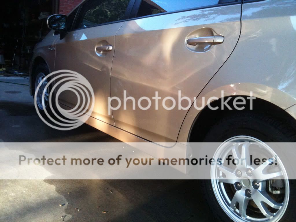

    After some sanding, priming, color coating, clearing and baking:

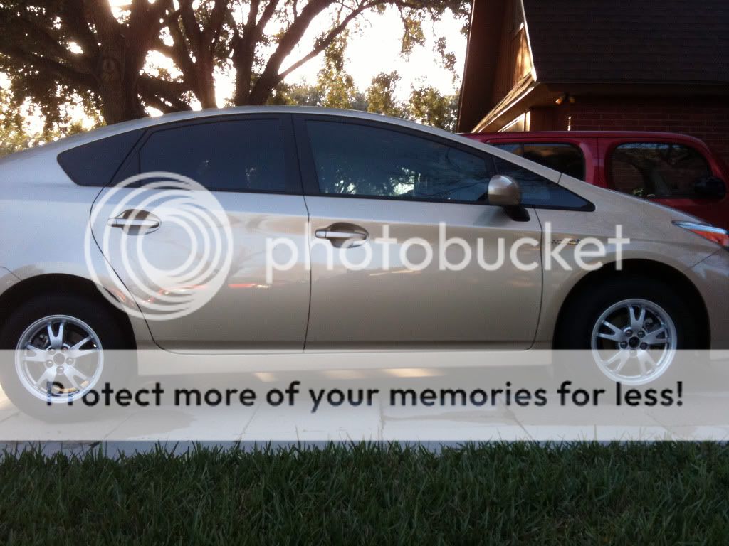

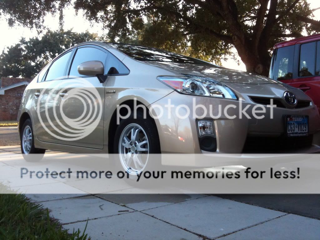

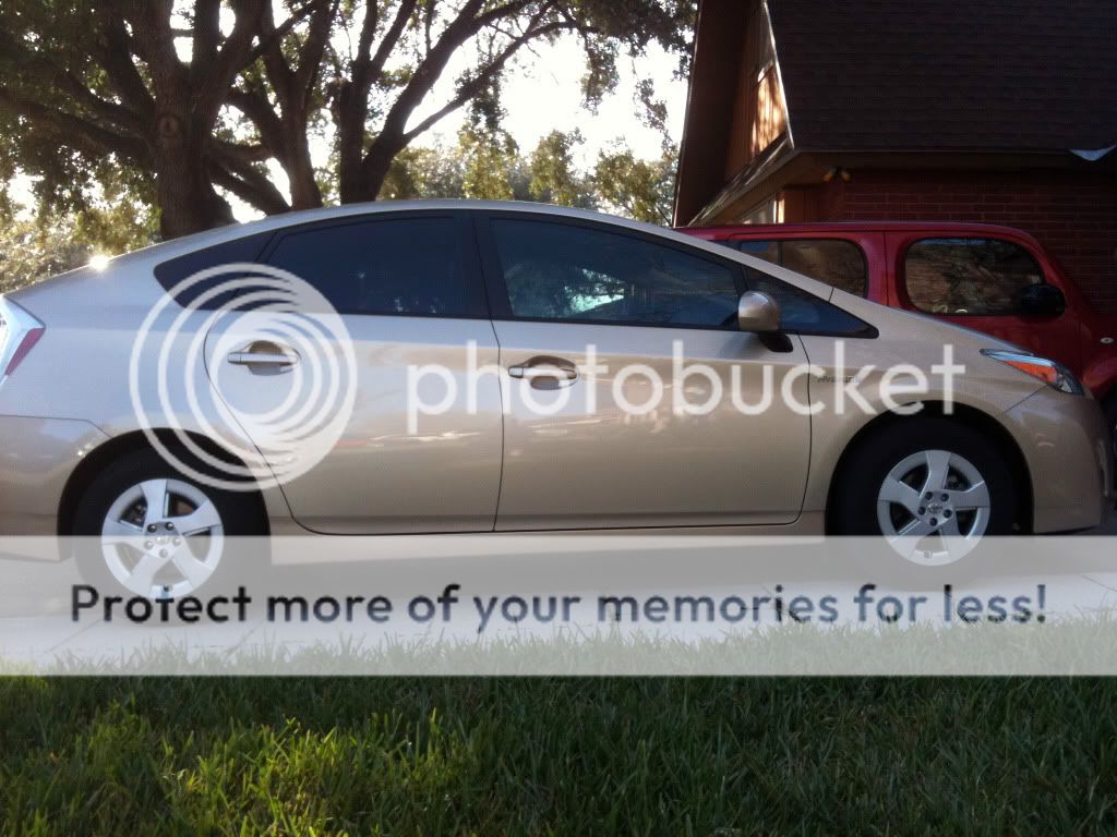

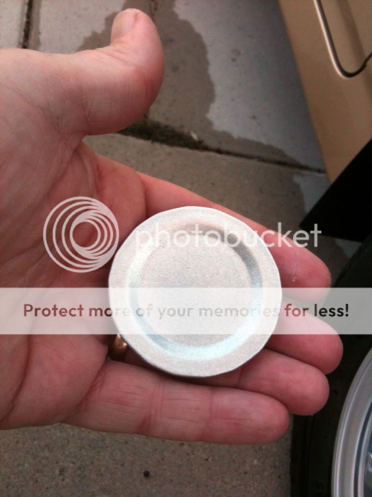

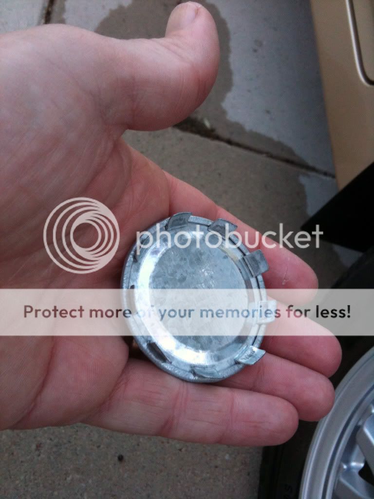

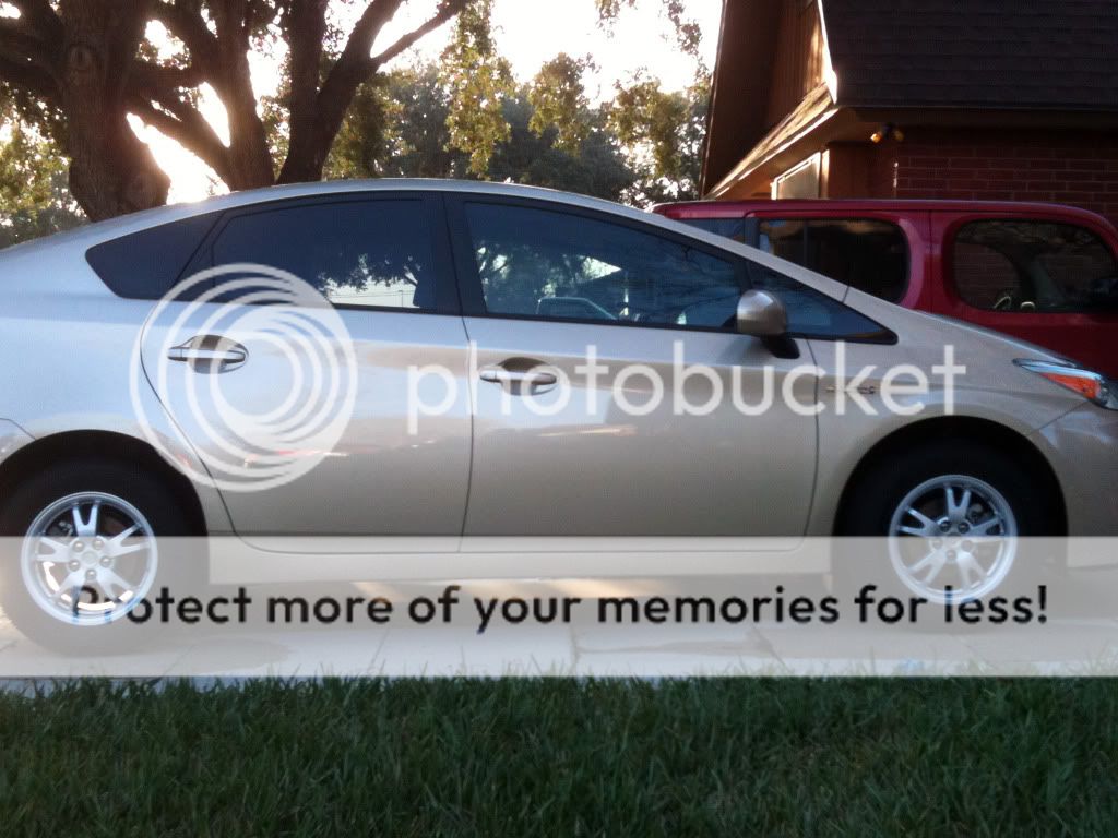

    Just finished mine today along with doing a 5K tire rotation. I used rustoleum's silver metallic spray paint mainly because I all ready had it on the shelf. It's not a match but it's in the ball park.
    Before:
    After removing the wheel covers and cleaning:
    Electrical knock out caps painted and cleared (unpainted backside shown for comparison) :
    And center caps installed:

    Here's a look:
