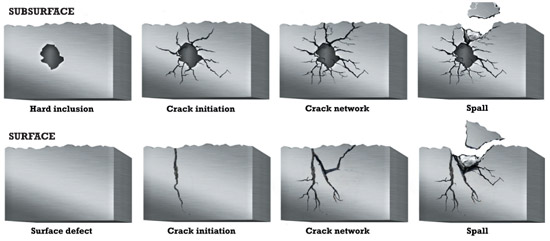

    Just sharing some recent insights:
    --- In [email protected], hobbit@... wrote:
    > I finally wrote up the bad-wheel-bearing incident from December; y'all have
    > seen the gist of the leading text here already but the detailed shots of
    > the bearing parts are toward the end.
    > Wheel bearing
    > On one hand a PITA, but on the other I have to admire what those little
    > suckers can go through and survive.
    Found an even better article:
    "How to Determine Bearing System Life" by Erwin V. Zaretsky
    Hobbit's bearing photos are dead on for 'spall' damage.
    This article goes on to illustrate two mechanisms and includes a probability table:
    27% - corrsion pitting
    20% - debris denting/contamination
    17% - dimensional
    17% - Other
    7% - handling
    6% - wear
    3% - cage wear
    3% - fatigue
    I was especially interested because the article discusses the L10 (aka., probability of 10% failure.) This is not the first wheel bearing failure. My thinking is researching all Prius wheel bearing failures and the accumulated miles could be treated as the L10 wear miles. Certainly not perfect, it may lead to a 'rule of thumb' on the wheel bearing, expected life.
    We might take a 'cheat' and consider each car to have exhibited the L25 (one of four wheel) failure rate. But this could lead to a too conservative rate.
    So why is this useful?
    If we have an expected 'useful life' for the bearings with some basis of estimate, we can proactively replace the bearings at a time and place of our choosing ... possibly shopping around for a better deal. Then not worry about it for a long, long time.
    Regardless, it is an interesting article.
