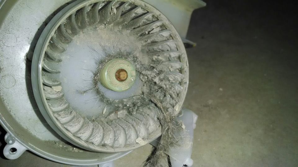

    Since there isn't a filter, I would at least suggest you check the fan periodically.
    I posted some pics this week on my company facebook page showing some horrendous Prius fans I've seen this week.
    They were both on cars whose hybrid batteries failed.
    http://bit.ly/1MnVrXE
    http://bit.ly/1AbvqD6
