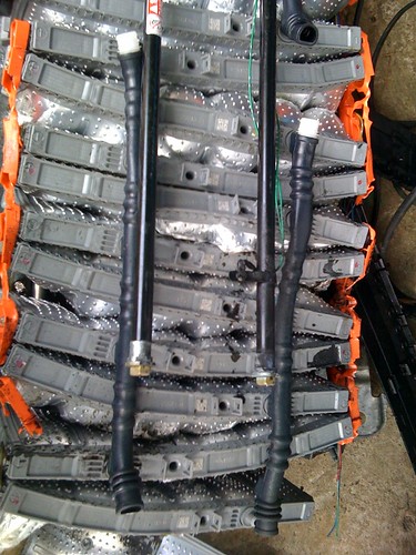

    First, about me and my Prius: I did a partial restoration on my 2005 Prius HV pack 5 years ago. After barely driving the car at all during 2020 because of the COVID19 pandemic, I recently had a POA80 fault. After clearing the code the car is again behaving well. I have reconnected my OBDII Bluetooth adapter and the Torque Pro Android app that I used 5 years ago. Once again I’m monitoring the HV pack in order to determine if more modules are failing. I have logs and data from 5 years ago to compare with. That way I expect to be able to tell how much my HV pack has degraded. Perhaps I simply didn’t drive the car frequently enough to keep the HV pack properly charged and cycled?
    Next, some recommendations for you:
    You should emove the top cover from the HV pack and perform a detailed physical inspection.
    My procedure is to remove the bus bars from both ends of the 28 individual NiMH modules. Check for loose fixing nuts, corrosion, and for any signs of overheating or of electrolyte leaking out of individual battery modules. Note: With all the bus bars removed there is no “high voltage” present anywhere.
    Each individual NiMH module should measure 7.0 to 7.5 volts in resting condition. It is safe to try charging each module at about 300 to 400mA from an adjustable charger. If a given module does not rise to >7.5V after several hours of charging at 300/400mA then it is faulty and should be discarded.
    I have several spare modules which I acquired (but didn’t use) back when I repaired my HV pack 5 years ago. I’ll check them to see if they are still holding any charge. They’ve been stored indoors but haven’t been charged or tested for 5 years. I’ll report what I find.

    Well, that doesn’t look good at all!
