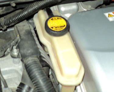

    To check for turbulence you simply put the Prius in "Ready Mode"
    Then raise the hood and look at the side of the inverter coolant reservoir. The backside (closest to the windshield) of the reservoir fluid level will look higher than the front side. Note that you are looking at the side of the bottle or in other words looking at the reservoir from the side of the car. If the Prius is not in ready mode, the level of the fluid should be even from front to back. But in "Ready Mode" the fluid tends to look higher in the back versus the front of the bottle. Below is a picture of the inverter coolant reservoir that I am referring to.
