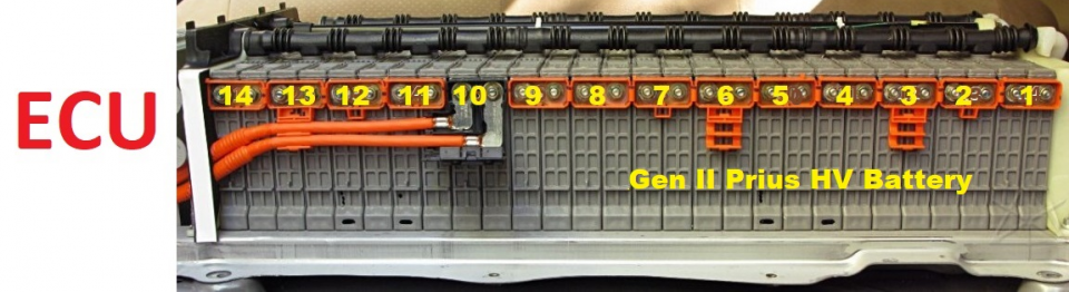

  10. ChapmanF
    26,488
    17,348
    PriusChat member johnjohnchu made this handy Gen 2 block numbering picture:
    So, assuming Dr. Prius numbers the blocks the right way, the service plug is included in block 10, so it wouldn't correspond to what you're seeing at blocks 4 and 5.
    If Dr. Prius has the numbering backward, then block "5" would be the one with the service plug—but it would be pretty weird for the service plug to show up as a lower resistance.
    So I'd guess the differences being shown are just attributable to something else.

  13. ChapmanF
    26,488
    17,348
    Oh yeah, those have block-width doublewide modules, right?
