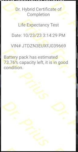

    I personally carried out the mentioned procedure on one of my cars and got some results, let's find out how logical it was. Long story short, I bought a 2015 Prius, I didn't do any service, I just checked the capacity with the app and it showed 55.27%, after that I started the procedures, cleaned the cooler, cleaned the contacts, cleaned everything possible in the hybrid, after that I started to rebuild them one by one with this device and get 73.76 % (I checked a week later, not immediately) recondintioning procedure done according to the instructions which was found on the Internet
    All batteries reached the maximum capacity of 7500, some on the first try, some 2 or 3, I expected more results, what do you think I did wrong or what was needed in addition to give more results, for example 80 - 90%
