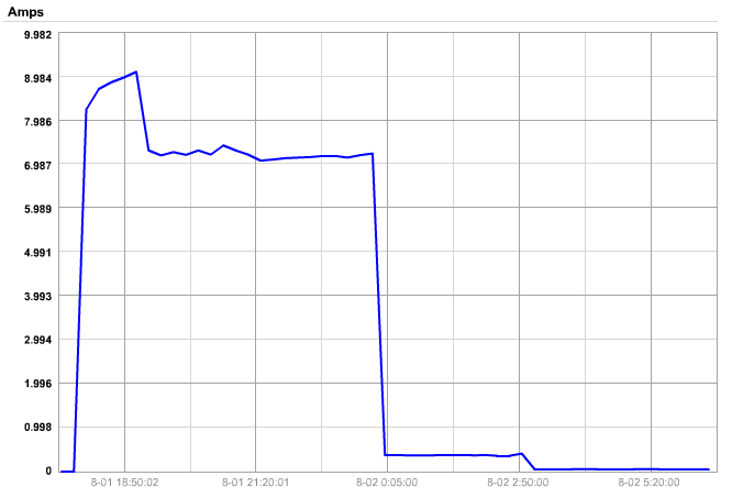

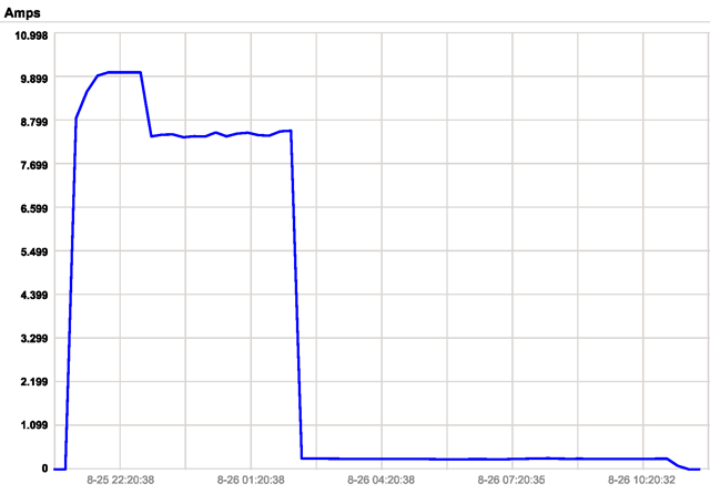

    I was finally able to get a charge graph of the new refurbished battery. What is interesting is that the refurbished battery is charging about 1A lower than the original which makes the charge time a little longer by about ~30 minutes.
    Please note the time scale is different for each picture.
    Here is the original new battery charge amps.
    Here is the refurbished battery charge amps.
