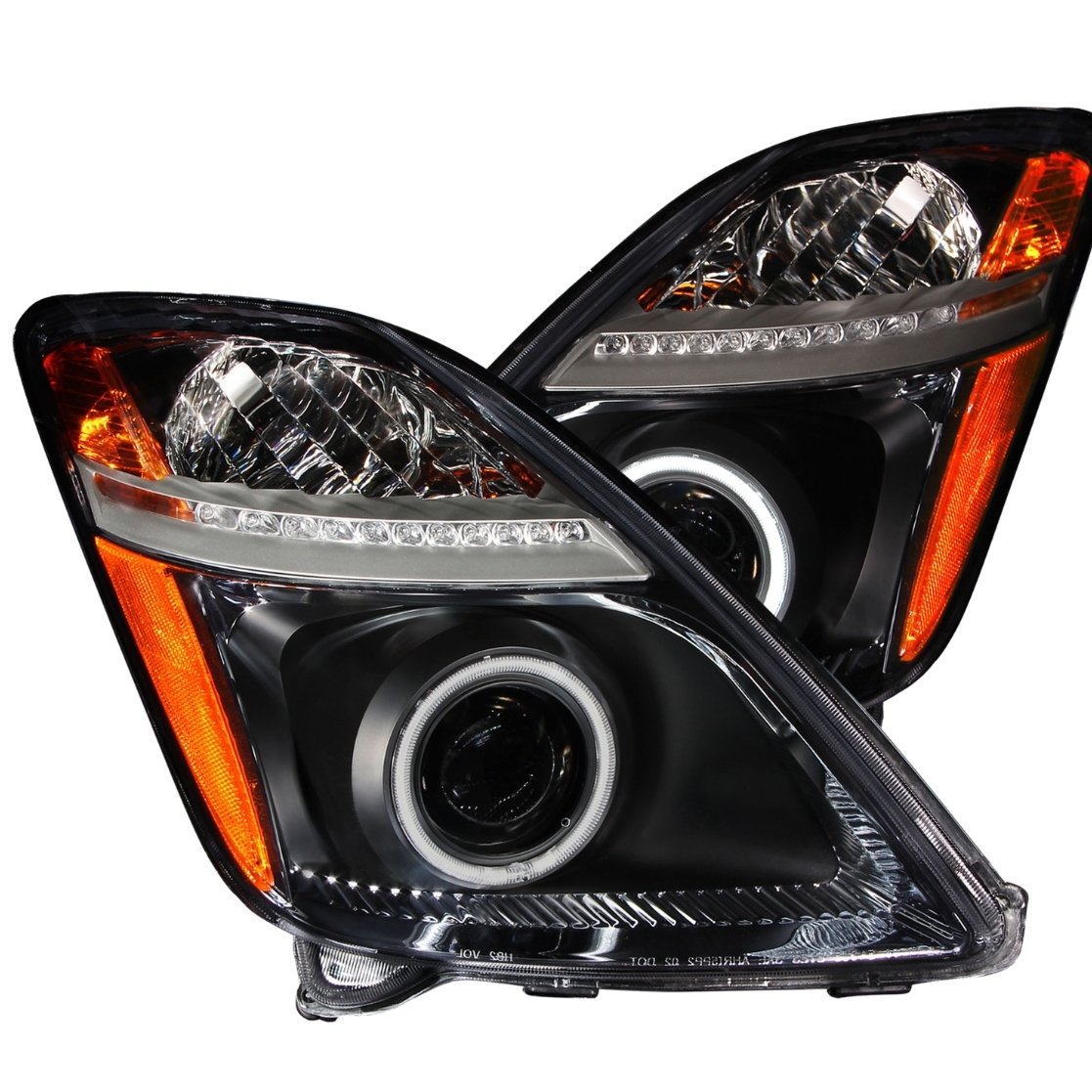

    If i had a gen 2 i would upgrade to headlights like these, a projector is way better at spreading light at the right places then a reflector. These r DOT and SAE certified (legal on-road). I dont know if these r made for halogen or xenon, i imagine its made to just slap the original halogens in, but i would instead slap some LED`s or HID`s in them. These would concentrate the light output way better the any reflectors.
    Anzo 121291 | ANZO USA Toyota Prius Projector Headlights W/ Halo Black (Ccfl); 2004-2009 [​IMG]
