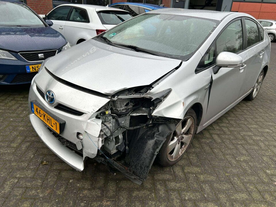

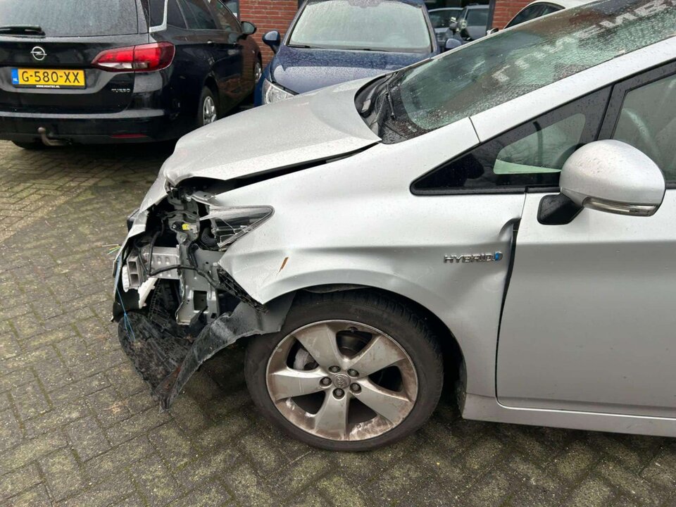

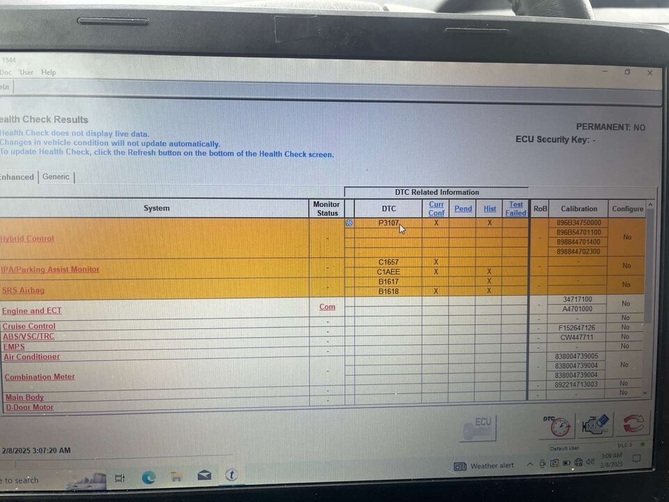

    Hello could you please help me find a faster way of solving this issue?
    Battery seems to be okay, i think there could be an issue with airbag sensor or the ecu, also wiring, where you should start looking for issue? 473697691_1129934558724065_4939402733015230000_n.jpg 475387987_638635451952088_987415942120445851_n.jpg 475782701_591454773759854_8981064707237469086_n.jpg 475539187_1328062158337727_2135048207619307218_n.jpg

    B1617, B1618 DTC are stored when a malfunction is detected in the left front airbag sensor circuit.
    The sensor or wiring to the central SRS unit is damaged in a collision.
    For safety reasons, the system does not allow the hybrid system to start.
    It is necessary to restore the wiring and replace the triggered sensors.

    The problem was with the wiring, everything works now.
