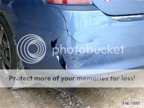

    A month ago, I got hit by a pickup truck while I was stopped at a red light. :( Luckily, the damage was confined to the corner of the bumper, as can be seen below:
    Repairs involved replacing (and repainting) the bumper cover, and some very minor body work on the rear quarter panel.
