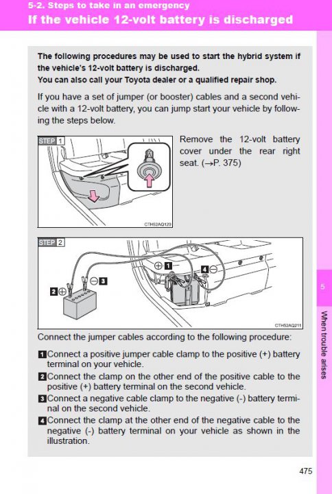

    Well under the hood there are no jumper connector spots right? I have to lift the back seat up in the event I need a jump?
    What is the life of the lead-acid battery? What are the warning signs that it needs to be replaced before it dies one day?

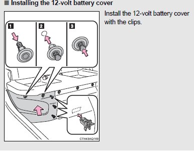

    It doesn't look too hard to access (famous last words?). Looking at the Owner's Manual: you take out two fasteners (the easy, push in centre button type) and pull off a small section of the rear seat skirt. Not the whole seat?

    This thread has a photo and more information.
    Prius C 12V battery | PriusChat
    A warning sign is decreasing voltage before starting the car, I'd recommend monitoring this with a ScanGauge or equivalent.

    Yes, and to replace the battery cover you replace 5 fasteners???
