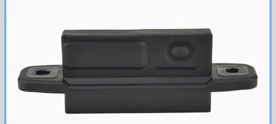

    My SE model doesn't have trunk door lock button like this picture.

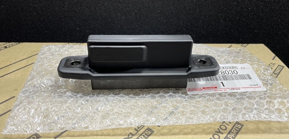

    So I want to upgrade it myself, I baught like this button.

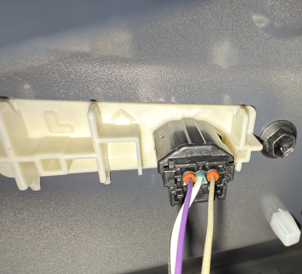

    I tried the button change, big square button is working, but circle button(door lock button) isn't work...
    So I want to see the XSE or XLE trunk disassembly pictures. Is there anyone who has the picture?

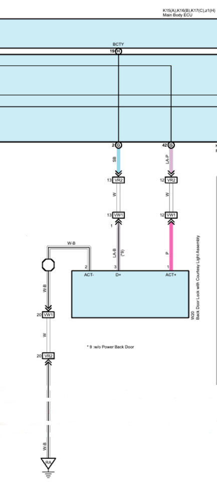

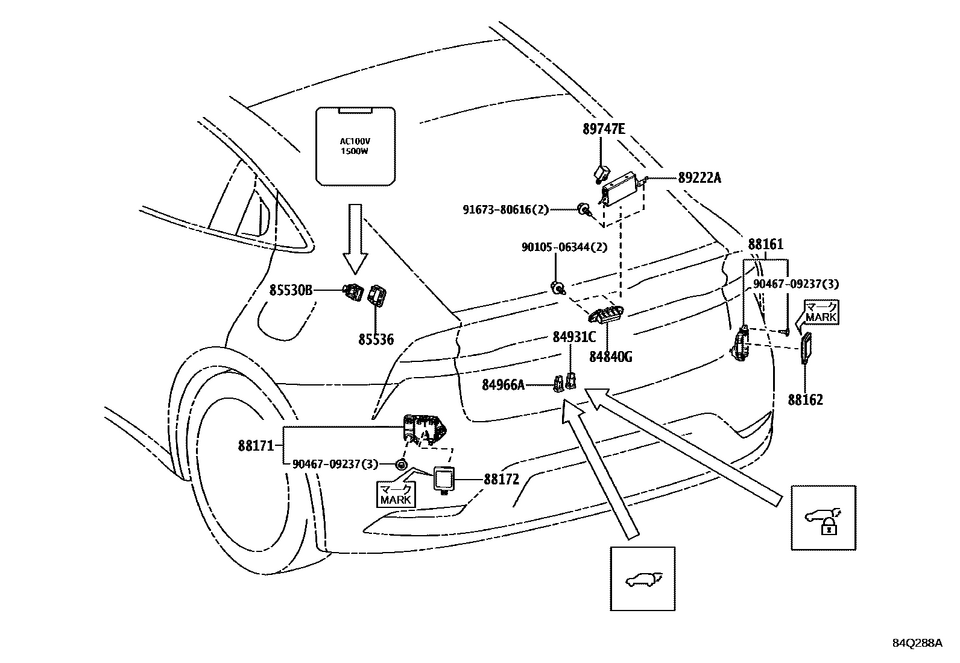

    And I found a trunk door locking part assembly guide like this.
    With this pictrure, I changed only 84840G, So I think that I should have to buy and install 89222A and 89747E. Is there anyone has a picture of 89222A and 89747E??
