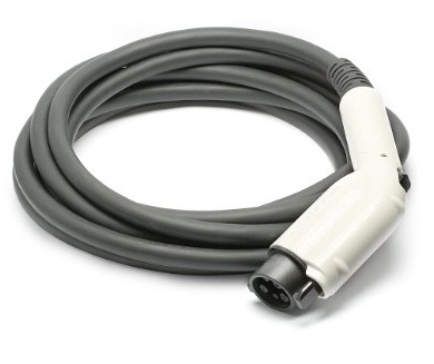

    It seems like you have the raw J1772 connector and cord like this:
    And you're trying to figure how to make a simple 3 prong plug to connect the other end to a standard household electrical outlet?

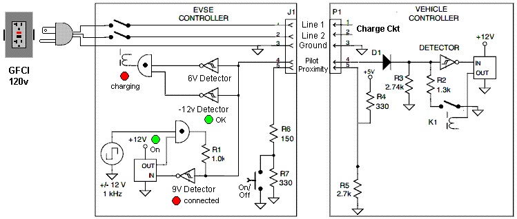

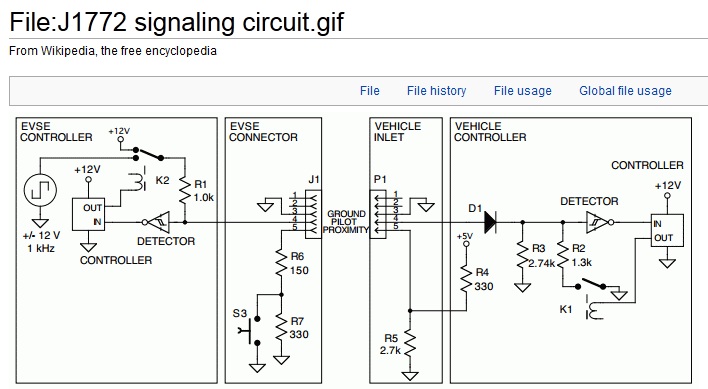

    If that's the case- you cant. You need the control/signal circuit between the J1772 connector and your home electrical supply. That's whats in the "reset box" (along with a GFCI) on the OEM Toyota EVSE set.
    SAE J1772 - Wikipedia, the free encyclopedia
    And here's the full circuit with the AC source..
