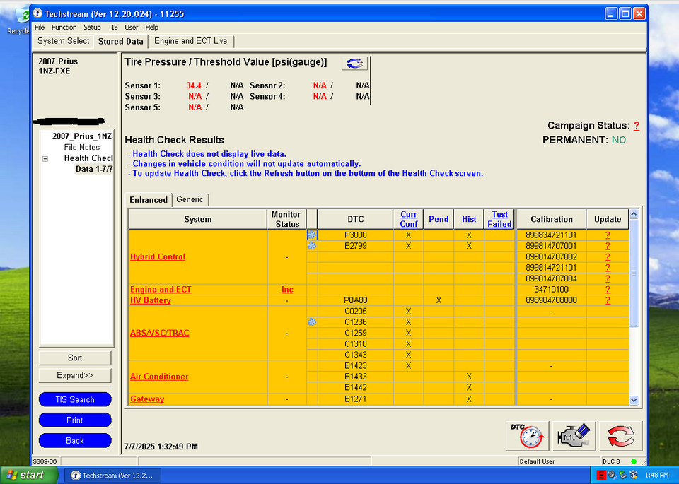

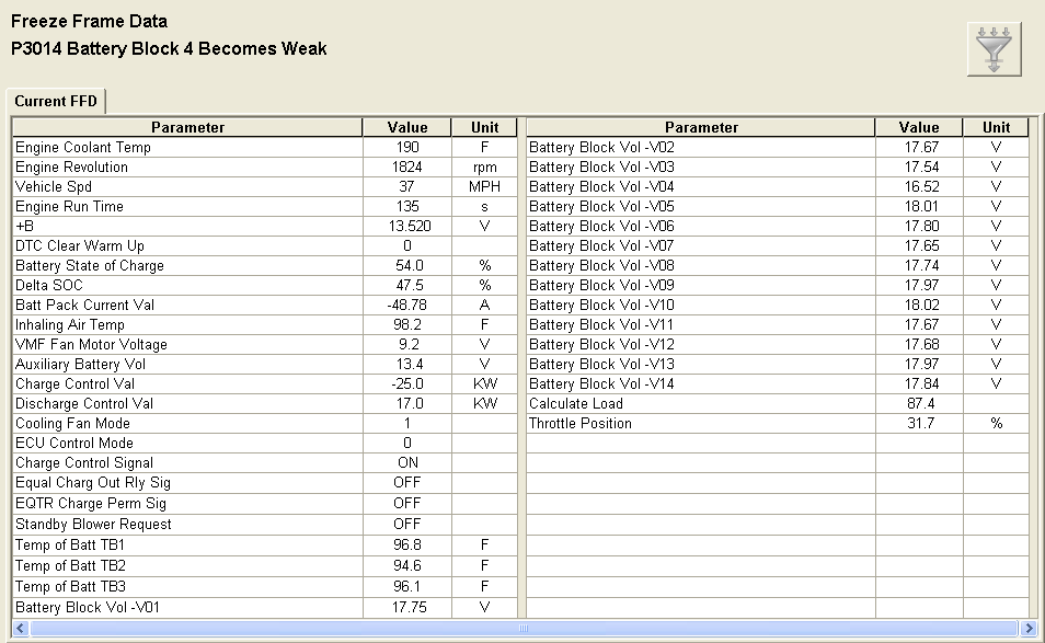

    I guess I bought what could just about be called a lemon Prius. It's got a lot of error codes regarding the brake system, and on top of that the battery pretty much quit working altogether near the end of the drive home, it's stuck in limp mode. The one code I didn't find listed in this readout was p3014, cell block 4 is weak. The battery is supposed to have a lifetime warranty from green bean, but they're giving me trouble transferring it.
    Anyway, could someone with more experience with these cars take a look at these error codes in the attachment and give me a roadmap of all the things I have to do to get this thing working again? This is my first Prius.

    That's lots of info, but I'm more curious as to what comes back when you disconnect the 12v for a few minutes to start it up fresh... Some of those error codes might be super old / no longer relevant and which ones come back right away will make it easier to know what to focus on first.
    Also a weak 12v battery on its own can create all kind of madness like this so make sure you got that covered.
    And as always when you get alot of error codes it can mean alotta wires / plug is not connected anymore and that's a straightforward fix.
    Are you doing the work? Or is someone doing the work for you?

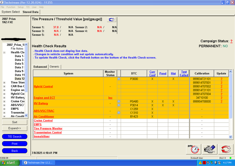

    the history codes can be cleared but I bet the current ones on the ABS will surely come back. Try clearing all the codes first and see what comes back.

    Sounds like a perfect clause (for them), considering when you have an HV battery code you'll also always have an HV system (P3000) and brake system (C1259 / C1310) codes....

    I'm planning on doing as much of the work myself as possible. I cleared all the codes a few times and drove around a little, I attached the new readouts.
    Battery is less than a month old, Toyota TrueStart.
    My issue with GreenBean is (imo) way more irritating than that guy's. I made sure to give them everything they wanted within the 7 days. I bought the car from a couple, the car was in his name, but the name on the battery invoice was hers. Because the names don't match they're trying to deny me my warranty. Dealing with this is ongoing. Based on the readouts I'm getting it's maybe just a few cells that are bad, but I can't pull the battery apart to replace them because that would void the warranty for real.

    C1259 is the ECB code that means "hey, you have some code(s) for Hybrid Control, go look there". C1310 is the VSC code that means the same thing. They don't mean there's anything wrong with the brakes or stability control at all, just letting you know that coordination with Hybrid Control won't be happening because of the code(s) reported there.
    In the OP's Techstream screenshot, you can see the P3000 Hybrid Control code (reported because of the P0A80 battery code), and the C1259 and C1310 ABS/VSC/TRAC codes (reported because of the P3000).
