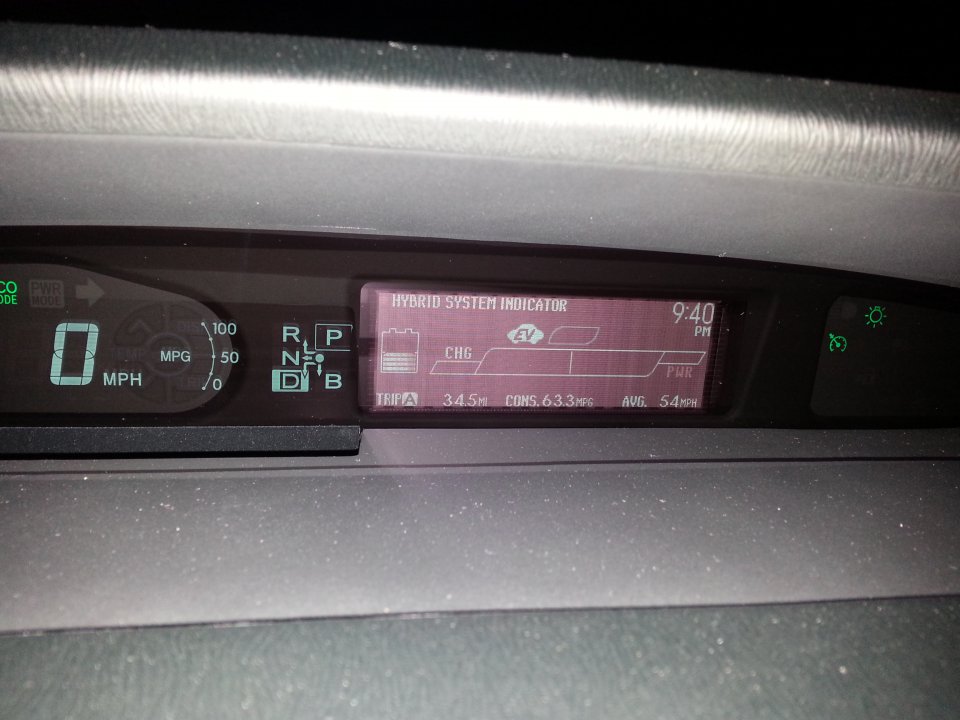

    I'm a new 2013 Prius III w/solor roof 9-13-13.jpg owner too. About three 3 weeks old. Bought it the end of August. I just drove about 35 miles using cruise control. I achieved 63.3 MPG @ 60MPH. My cruise was set, and it did a great job. I'm very impressed so far.
    I see no reason to buy any other car but the Prius. Why would you? Makes to sense to me... If you are looking at a car for $30K, then the Prius would be the only car for you...
