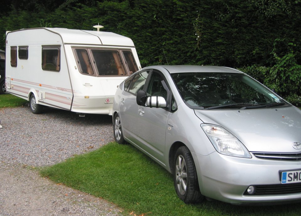

  15. Britprius
    Britprius Senior Member
    Jun 14, 2010
    5,194
    1,914
    Herefordshire England
    A picture I have posted before of my trailer that weighs 2420lbs loaded and towed without problems now for many thousands of miles.

  17. Britprius
    Jun 14, 2010
    5,194
    1,914
    The trailer has a body length (not including the towing bar) of 16ft 6inches tow bar adds another 3ft 6inches, and is 7ft 6inches wide. The trailer has it's own radio controlled electric drive system for easy parking. Go to about 2minutes 30 seconds in the linked video.

  19. Britprius
    Jun 14, 2010
    5,194
    1,914
    The Prius is a lot more capable at towing than many believe. I do take sensible precautions like monitoring important temperatures, but find towing within our legal speed limits "50 mph on normal roads 60 mph on motorways" to be perfectly reasonable driving sensibly.
    Wind resistance with my particular setup probably plays a bigger part than the weight. The trailer has it's own braking system, and the car stops better with the trailer than it does without.
    Fuel consumption with the trailer shows a loss of around 15 mpg usually in the high 40's dropping from the mid 60's bearing in mind our gallons are 10% larger than the US. I put these very good figures down to the extra regen from the weight of the trailer when slowing down, and driving at sensible speeds.
    I would imagine the trailer you are anticipating towing will hardly be noticeable on the rear of your car.
    Possibly the only difference with my setup compared to the US is the actual tow bracket on the car. My bracket fits in the same way as the US bracket, but also has a center beam going forwards under, and fastened to the spare wheel well to act as a cantilever for the weight on the tow hitch that I load to 130 lbs. It also has an anti snaking device that doubles up assisting with reducing hitch weight.
    John (Britprius)
