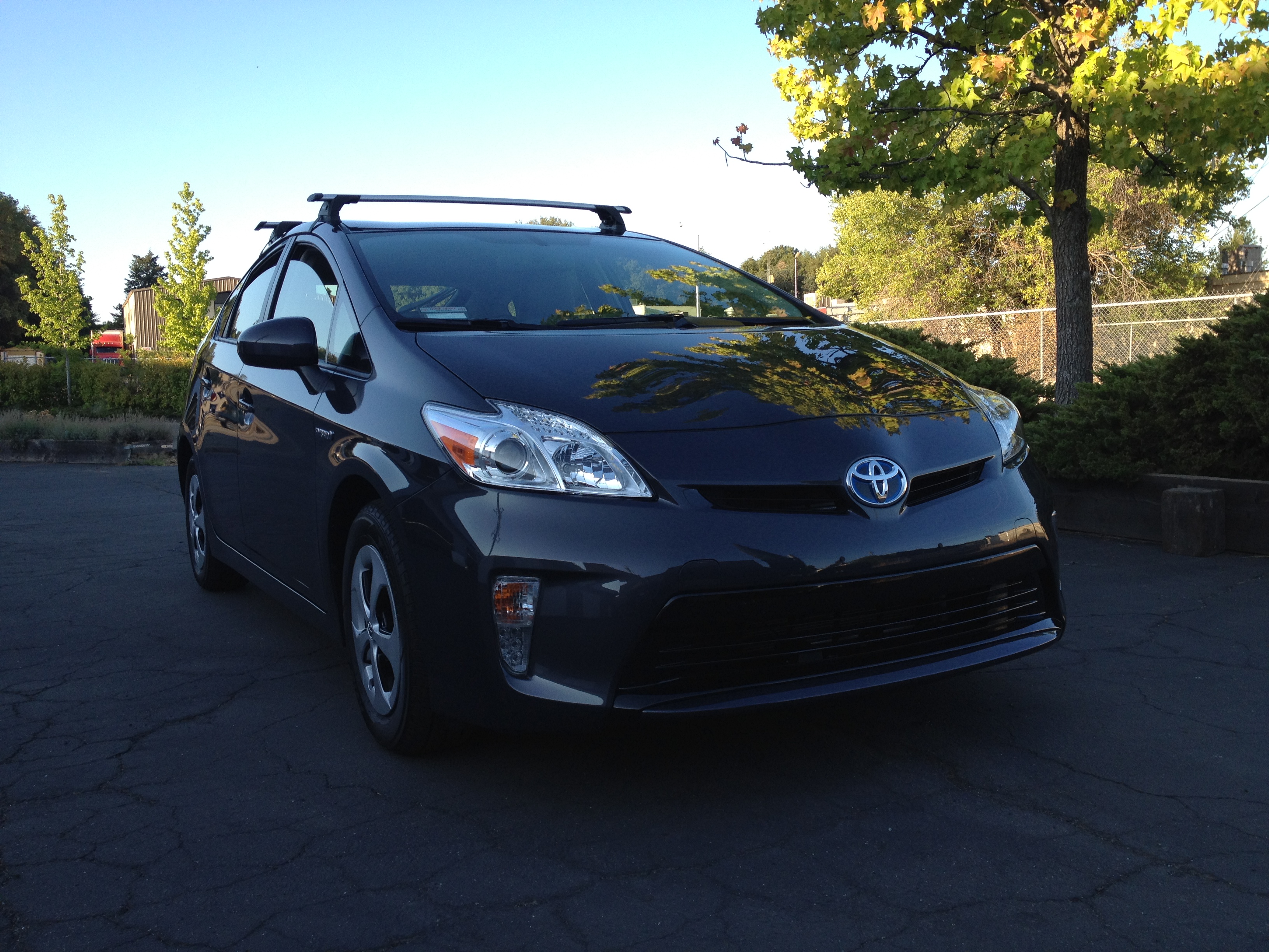

    I come from a Yakima roof rack user, i.e. round cross bar and Q-Towers. I was planning to transfer my old set-up from my old car (Acura RSX) to the 2012 Prius to haul two Trek mountain 3700 disc bikes, but after seeing Jimmy's pix of his Prius configured with Yakima's Whispbar Through System, I'm inclined to upgrade to the same system and eliminate the silly looking wind-noise eliminating 44" fairing:
    (Jimmy's ride)
    I like it because it looks very OEM'esque. Whispbar is suppose to be aerodynamic and reduces wind noise compared to round or square bars.
