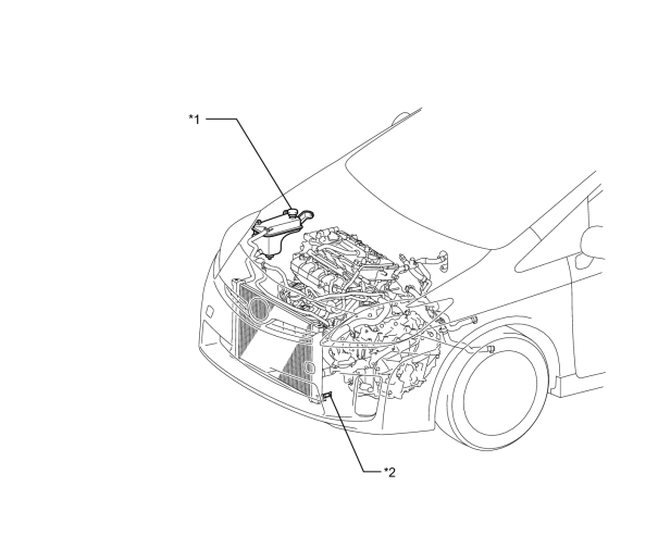

    To OP: The instructions you reference is for the 2010 Prius. For 2011 and later, the air bleed valve has been eliminated (the fitting still exists, but there is no valve), and the procedure no longer includes draining through the block drain.
    By the way, the replacement interval for the factory fill of SLLC is 100,000 miles, and 50,000 miles thereafter.

    Here's the inverter coolant change instruction:

    Wow that explains it. I have the older instructions. I wasted a good 2 hours trying to find it. When I removed that bolt the amount of coolant that came out was insignificant. I guess I did it right though I know theres still older coolant in there. When it says to put the car in inpection mode that is only acheivable using techstream correct? I tried searching but couldnt find how to do it.
