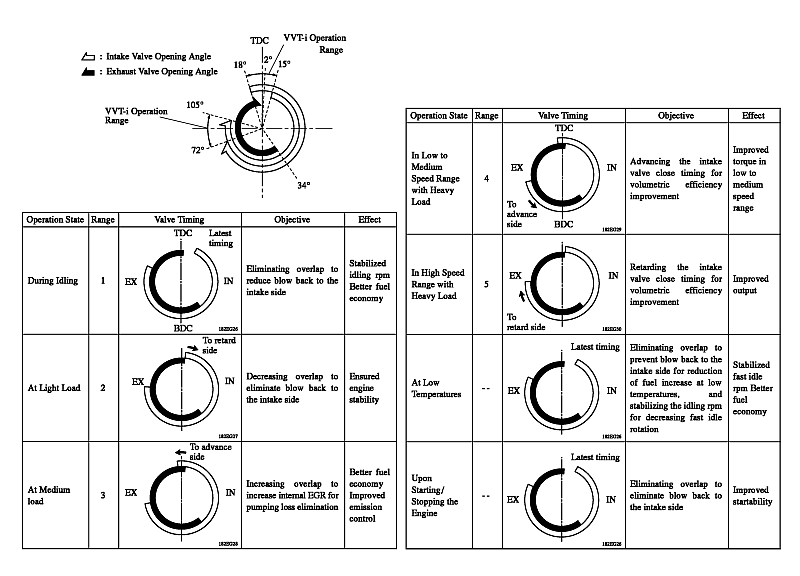

    If Prius has to constantly spin the ICE when over 42 mph, even when only running on battery power, it must waste a lot of energy overcoming ICE compression all the time. Or is there some kind of system to reduce compression in this situation – just curious :)

    I wager that the North American market Gen II ICE will run continuously above 41 mph with your foot on the gas. Coasting, different story. Still, I believe EV is not possible above 41 mph without ICE engaged, and that would not be EV. Interesting though, wonder if the variable valve timing, intelligent (VVTi) has an open valve position. Somebody must know.

    Think of the cylinder as a spring, while it takes work to compress it, you get almost all that work back on the decompression. Altering the valve timing is possible.

    Does the gen 2 Prius have VVT-I, mine is described as VV-I but I don't know what that stands for or means?

    I suspect VV-i of being the buzzword in nations where VVT-i was already a trademark for some other company.

    So is the Prius engine able to pretty much free-wheel with the engine running but no load? It feels very much like it's in Neutral, to me. My ScanGauge shows rpm (around 900) and zero fuel consumption, fwiw.
