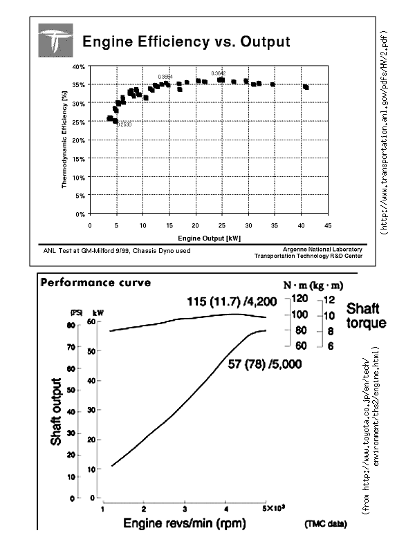

    I agree with JimboK with the ICE high efficiency at those low RPMs. If you plot hp from the graph below, 15 hp to 20 hp are around 1,200 RPM to 1,600 RPM. Prius ICE is 35-36% efficient at those low RPMs. Otto cycle ICE can not touch it even at their peak.
    To answer OP's question, I accelerate with the battery 10-15 MPH before the ICE kicking in. The reasons are:
    - A chance to use the power captured by the regen brake.
    - Minimize conversion loss from ICE. Below 10 MPH, most of the ICE power goes to the generator.
    At 0 MPH and if ICE runs at 1,500 RPM 100% of the power (~18hp) goes to the generator to power the MG2. If the ICE were to kick in at 15 MPH, 56% of the power goes through conversion and 44% goes through directly to the wheels.
