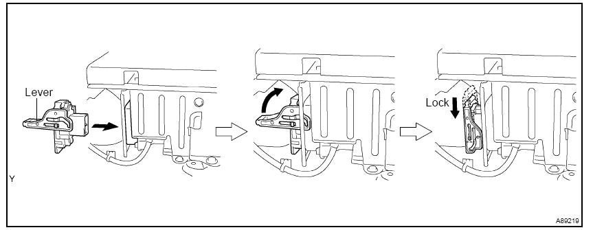

    Good afternoon. I've tracked down my A/C problem to a non functioning A/C compressor, so I went and got one from a parts yard that specializes in Prius'. I installed the compressor, which was relatively easy, and then inserted the orange power cut off switch into the HV battery pack. I also put the cable back on the 12 volt battery. The instant I put the lead onto the 12v battery lug the red triangle of death appeared on my dash. Also every warning light came on, and stayed on. So after scratching my head I tried to power off the Prius, by depressing the start button, it did not want to shut down. So I pulled the orange plug and nothing happened. Then I pulled the 12v cable off the battery and the car shut down.

    Did you lock the switch when you put it back into the battery?

    No, I had not pushed down on it to lock it. I just went out to my Prius after your comment and LOCKED it but that had not effect on the problems. (shrugs shoulders)
