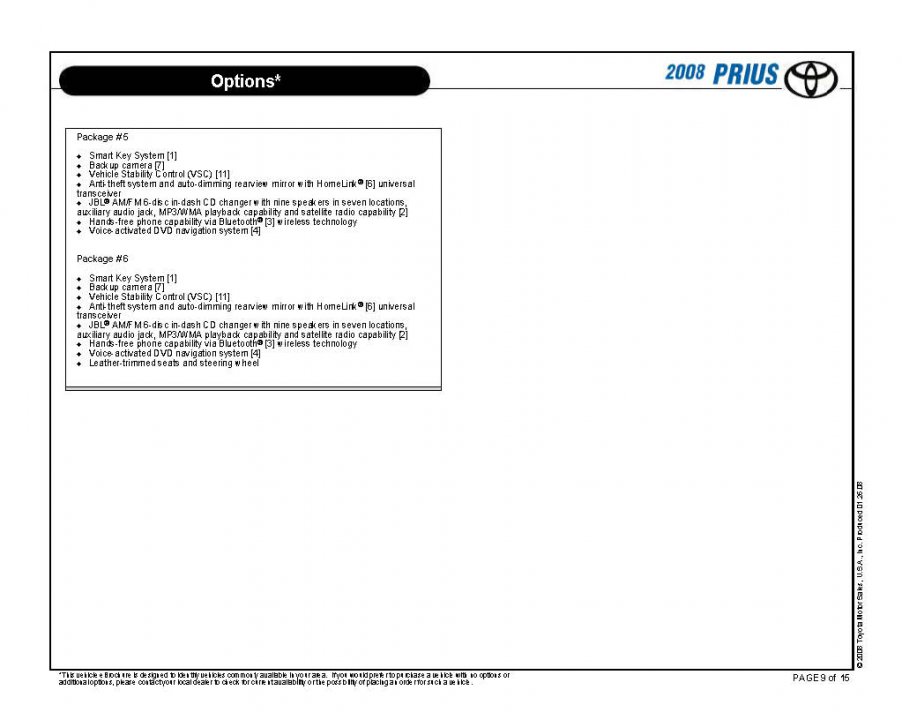

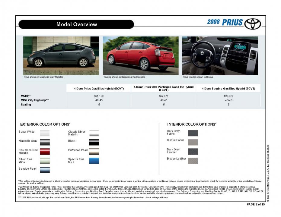

    here is a decsription of the various trims

    The "Touring" model has extra features over the base trim package it is in. However, many dealers and sellers have no idea what the heck they have and misrepresent the models as Tourings when they are not. The touring models come with larger diameter wheels, a stiffer chassis and a few minor handling things in addition to the interior trim options. If you are in the US, the Touring is generally the package #6 + touring package.
    2008 models come in 6 standard flavours:
    They all have the MFD (the screen in the middle). If you have navigation then you will also see an extra button on the left side of the screen that shows the map data when you press it and an extra button on the steering wheel controls for the map feature. Other than that they look the same.

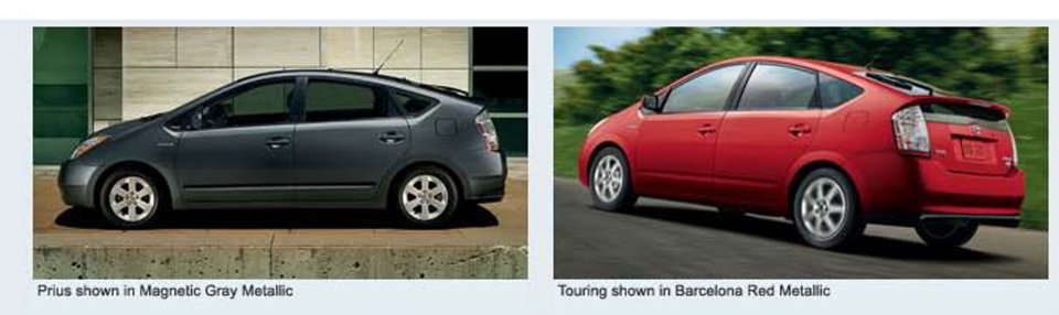

    No, because it has 15" aluminum wheels and the standard-sized rear spoiler.
    The Touring has 16" aluminum wheels and a larger spoiler. It also has different struts/shocks.

    I see it. I don't want to get ripped off. The touring has a spoiler that looks like this
    base,

    Figure it out look at the pictures and the chart. It has SKS because the little black buttons on the hatch and two front doors. Therefore it is above a package 1, not a base. Looking at the MFD, there is no navigation button so it is not a package 5 or 6. It doesn't seem to have fog lights, so it is a package 1-3. So that leaves packages #2 and #3.
    So if it has the autodimming mirror or 6-disk CD changer, it is a package #3. Otherwise it is a package #2. To me it looks like a package #2. Non touring.
