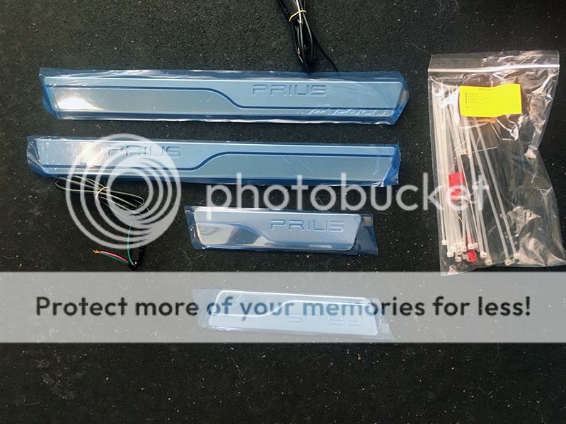

    Part number is PT942-47160. Here's what it contains:
    Comes with all the needed hardware.

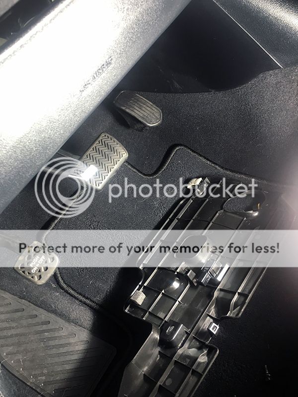

    First remove the scuff plates next to the door and the kick panel. Pretty simple--scuff plate is attached only at the ends, so just yank it out. Kick panel cover has a screw towards the firewall that must be removed first, but it's easily done.

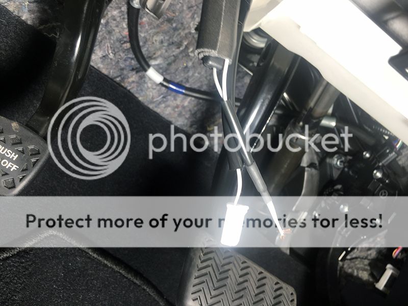

    Next, remove the panel located under the driver's side dash. Two screws and one clip. Comes out easily. Disconnect the footwell light. Footwell light is where we'll tap in for juice later:

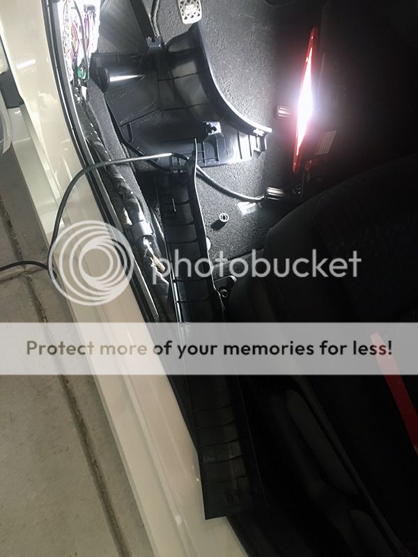

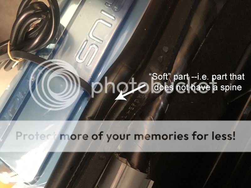

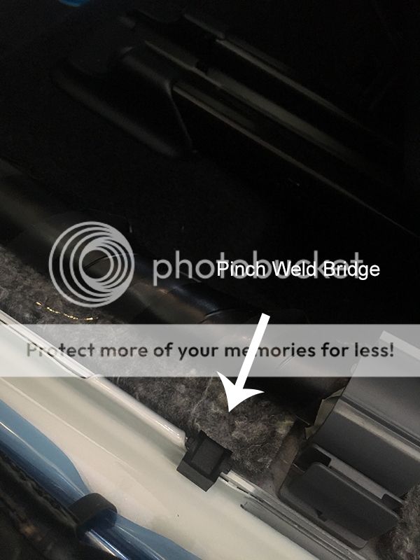

    Next, insert the "Pinch Weld Bridge" on the body--used to keep the wire from rubbing against the body and fraying down the line. It's position should be a little forward of the rear OE Harness clip.
    Here is the wire crossing the "bridge". Secure with electrical tape, then replace the weather seal.
    One thing to note: the bridge must be placed under the "soft" part of the weather seal (i.e. part that does not have a spine):

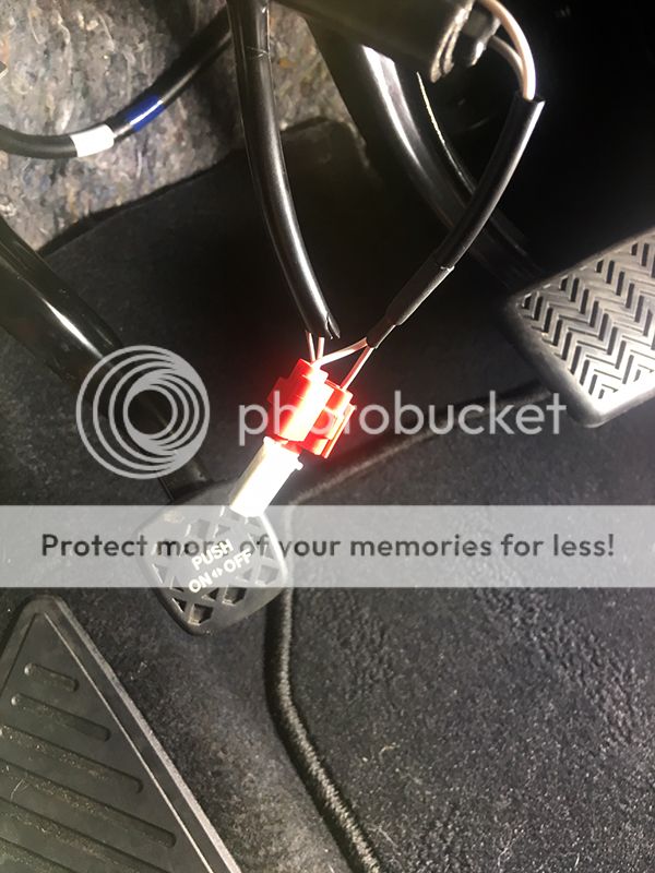

    Then route the wire along the OE wiring, above the hood release cable and behind the metal bracket you'll see. It was kind of tight, but not really bad. Here are the plug for footwell light and the door sills together, finally at last:
    Using the enclosed T-taps, connect the footwell wire with the Door sill wire. It's color coded--white and brown for the driver's side, pink and green for the passenger side. It's pretty stupid proof. Here's what it looks like after they're all connected:

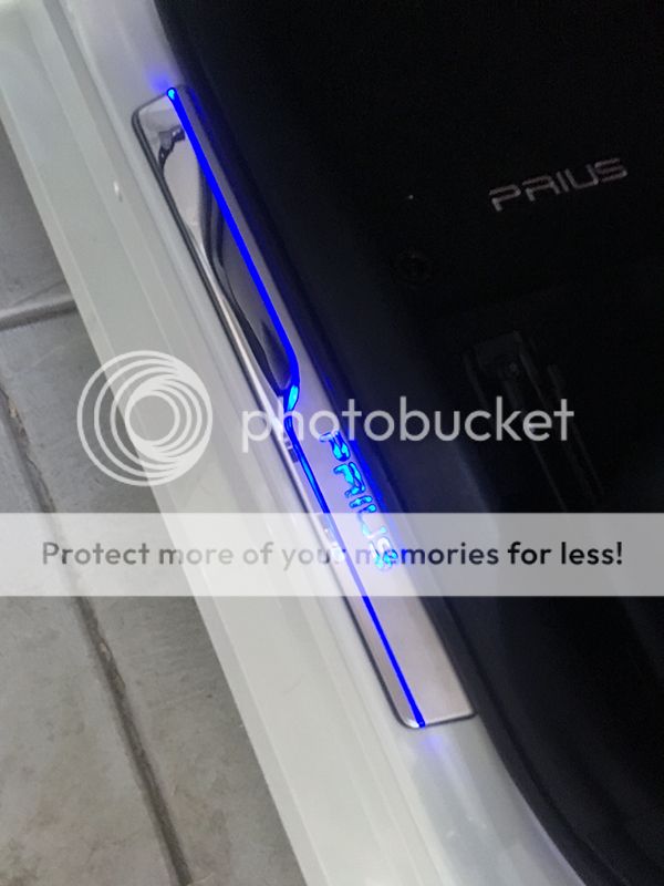

    Success!
    Looks pretty neat. I replaced the interior lights with LEDs so this blue complements well.
