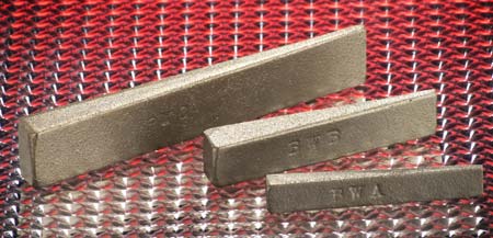

    You know ... your economy wedge set ... it isn't THAT much less expensive than a nice/real set:
    I'm just sayin' ...
