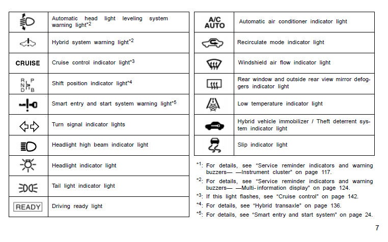

    Hi guys i'm new here. Let me start by saying i'm looking at buying a car tomorrow but have some questions.
    Today I test drove the car and was told that the key fob was lost and a replacement was programmed for the car to start...but not locks. But while driving it I noted that the Immobilizer / Theft deterrent light was flashing. Is this normal because everything i'm reading says that the car shouldn't even start. I know that the car isn't stolen because we are planning to take over the loan in the morning for the car at the bank. Can someone please tell me what I should do. If this is because the key was only programmed without the original then can I simply use this one until I can have Toyota make me a new key for around 350-400 based on what i'm seeing online. Any advice would be very helpful. Thank you.
    Below is the light that i'm referring to (car with key in it).

    On my 2012, when the fob battery runs out, I have to place the fob against the start button to start the car. Obviously, remote keyless doesn't work. If the door is opened with the car in READY mode the immobilizer icon blinks. If I place my key against the start button, it beeps and goes away, otherwise it blinks while I drive. The immobilizer works in concert with keyless entry in other words.
    I imagine they have the immobilizer working but not keyless like you said. Is someone opening the door while you're stopped? If you put the replacement inside the start button slot, does the icon go away?

    The key is a big issue. Ignore what I said about touching the start button, that's for a 2012 model. On your model it may be different. Try reinserting the fob into the slot. I was just offering an idea that a blinking immobilizer icon isn't something to worry about. Not having fully functioning keys is a big issue though. It could be $350 - $400 to replace a pair of fobs or it could be thousands to replace the computer.

    Alright well it's now daytime here and i've been buzzing on the phones with every Toyota dealer around and afar for pointers. Turns out that this can in fact happen if the key wasn't setup properly and the funniest part is 3 dealers in the town next to me referred me to a Locksmith that does their cars for them.. I gave him a call and he said he would like to check it out but is positive it's just in need of a new key (possible ebay key currently being used). He will meet me at the sellers and will program on the spot for a total of $315.00 that is new key and programmed for all features to work and the light will go off he assures me. So before the sale takes place i'm going to gamble with the key cost and see if it in fact does resolve the issue. I look at it this way, in the end i'd be buying a new key anyways so might as well do it on the spot.

    Well guys i'm proud to say that i'm a new Prius owner!. Key cost $340 total and light is off. I drove the care home and all is well. I do have a few questions because this is my first prius... Does the battery meter go up/down often.. I was in a drive through with the lights on and it dropped a few bars after about 10 or so minutes but charged right back up after a small drive..is this normal? Also my friend said that the shifter is odd.. When I put it in drive it clicks on the shifter (almost like plastic on plastic click) but only in drive. Thanks if you guys choose to help me with these questions.
