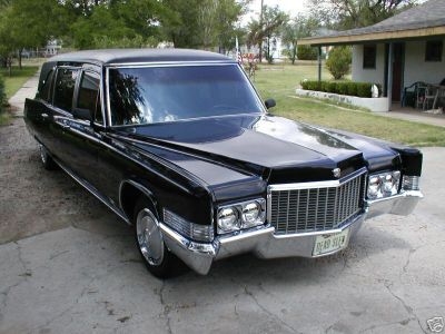

    I drive a 1970 Superior coach, which boasts a 500 cubic inch (8.2 liter) V8.
    (not my actual car)
    when I first got it, it got a stellar 2 mpg. two. that is more that $1.50 per mile to drive this thing.
    today me and a group of friends rebuilt basically everything on the drivetrain.
    upgrades include:
    race cam
    pre-smog era heads, with head job
    new intake manifold
    fuel injection and engine management system.
    removed smog pump
    4 inch cat-delete dual exhaust system, with custom headers
    700R4 trans (4 speed) 2 more speeds then when I got it.
    went from 4.33 (lower then low) to 2.10 (very high) gears in the diff.
    it has a 45 gallon tank that I have to use premium with octane booster and lead additive (158.90 a tank)
    vehicle weighs 6000 lbs curb weight, but with my custom casket-tool box, loaded with tools, it should clock in at 7k, and I have to tow pumps and generators for my job, 4-6000 lbs.
    any of you that have been to west Texas know, lots of long flat roads at 80 miles per... and my job (pump/generator technician for Oil rigs) requires lots of driving.
    any guesses on what kind of gas mileage I will make? and what can I do to make more MPG's? emissions are second to gas mileage, and catalysts just hurt MPGs too much to be worth it to me, but if you have any ideas for this-feel free to post
