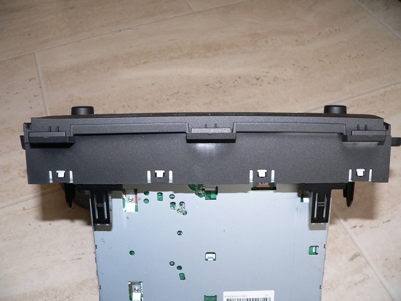

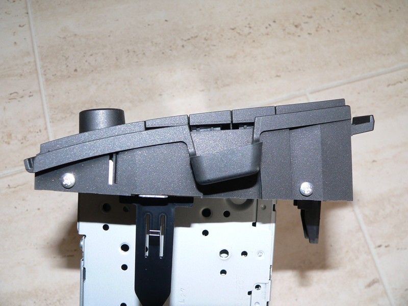

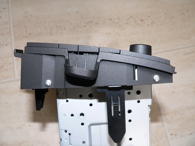

    The critical thing to look for is the side profile view, as I think this is where the main difference is between the LHD and RHD units. Here are some photos, first a view from the right hand (drivers) side of the RHD radio:
    Next, the view from the left hand side, note the way the fascia turns up at the right hand side, when compared to the other photo:
    Finally, here's a photo from the underside, showing the way the fascia curves up in the lower left corner (the left of this photo):
    Jeremy
