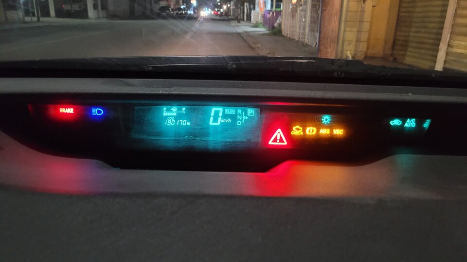

    Hello, everyone, I just bought a prius to give it to my brother, the car was cheap because it needed to get fix, it has 1 one main problem, the brakes dont work properly, I have to push the pedal to the floor in orden to try stoping the car and it stops but it does slowly so i have to do it with much space before the stop sign, the pedal is kinda soft.
    My best guest it has to do with the ABS actuator.
    and the second main problem is that the hybrid battery is bad, cause the car wont stop running al the time, and I have lots of codes on the dash board, will add a pic of it down below, also, when I start the car the acceleration response is good but after a while it drops down so much it takes for ever to move and get speed.
    How can I troble shut the brakes, that my question, to acctualy know that the ABS actuator box has to be replace, what codes do I have to look for.
    Thanks for any help you can give me, salutes.

    You don't have any codes on the dash, only indicator lights that tell you the car wants to tell you what ails it. Each light indicates the corresponding Electronic Control Unit (ECU) has something to tell you.
    That does not tell you that the hybrid battery is bad (it may be bad, but that symptom doesn't tell you that), it is more likely that the Combination Meter (CM) has a failed capacitor (or two) that need replacing.
    The right way to think about this is, scan the car and tell us what codes you have.

    Okey! Thanks! I will look foward to get the car scanned ASAP and will update my post, salutes!
