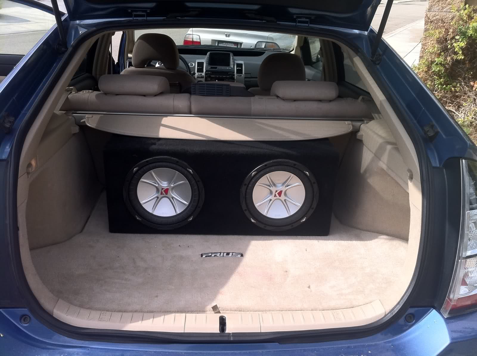

    I just had my subs installed in my 2004 Prius. Might be a bit overboard, but it really sounds clean.
    I also swapped out the speakers for upgraded JBLs (I blew out the factory JBLs).
    2 10" Kickers in a carpeted box powered by a 1000w Performance Teknique with a custom bass knob installed by the "smart" button under the steering wheel.
    I also went out and bought an iPad, which fits wonderfully in the CD holder tray thing.
    skorpyo33 likes this.

    I assume the iPad is very easy to remove and hide when the car is parked?

    Haha yeah. It's just sitting on the tray. Nothing attached.

    I like the iPad action, I'm slowly leaning towards that instead of a traditional head unit myself.
    You guys with the dual monster subs, I don't get it! I love it but I don't get it. My single 8" driven by 250W gives more rumble than I can handle.

    Heh...Like I said earlier, it IS a bit unnecessary, but totally worth it. Prius at the drive-in? ...omg.
    1. You just leave the car on. Engine kicks on, charges when it needs to. You don't have to worry about the battery dying.
    2. The subs make the experience better than theater-like.
    But yeah, the iPad is totally worth it. I was thinking about having it custom fitted into a 300zxTT I had a while back, but ended up not. It works out perfect in the Prius because of that little tray. And since I can tether it with my iPhone, I've got Pandora, YouTube, Maps, and all the other wonderful internet apps wherever I go.
    Definitely worth looking into.
    I think the next step is rims. Anyone have any recommendations? I think I'd like to keep the same size, or at least very close. I had 18's on my Eclipse Spyder, but that would be completely ridiculous on a Prius.
