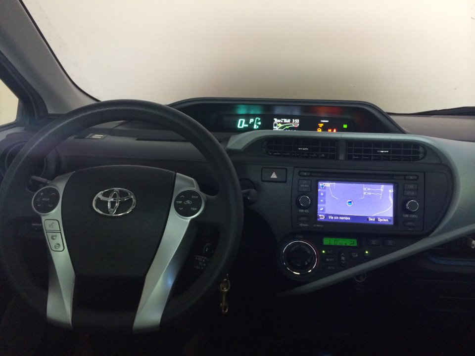

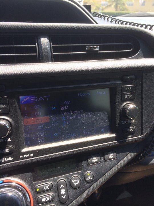

    I got everything research and working (Sat, Backup Camera, GPS) but I didn't ever bother with voice command changes as I never use it in my BMW too.. I know Rolopr is doing that and I gave him the wiring diagram to him.
    Yes, a used C3/4 radio will work in a C2. just need to tap into 3 wires on the harness. It took me 1 months to get everything figure out but I am glad to help anyone here. I am using GPS and listening to XM radio daily now.

    Installed Nav Radio and Steering wheel pads, Voice command works with the radio, but for some reason the Disp & Trip on the right steering pad now working.

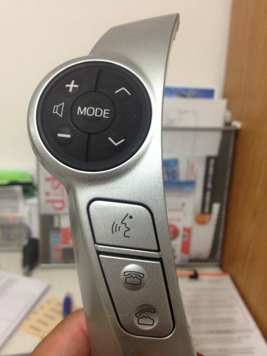

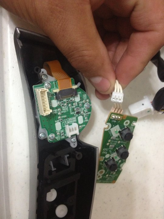

    Fix steering wheel pads, now everything works on the pads 100%.
    In order to use it on the PC 1/2 you need at least the left pad that have the voice command button.
    1. Remove everything ( including the black buttons shown) from the left pad pf PC 3/4 leaving only the voice command and bluetooth buttons (pad).
    2. Disconnect the board of the removed pad and replace it on the existing pads of PC 1/2. (see that have 3 black buttons, PC1/2 only has 2 buttons)
    3. Remove everything on the left pad on the PC 1/2 (without VC button) - 3 bolts only and installed on the PC 3/4 pad now (with VC button).
    Activate first the Bluetooth and cancel, then push the voice button for a few tries until the HU recognize it.
