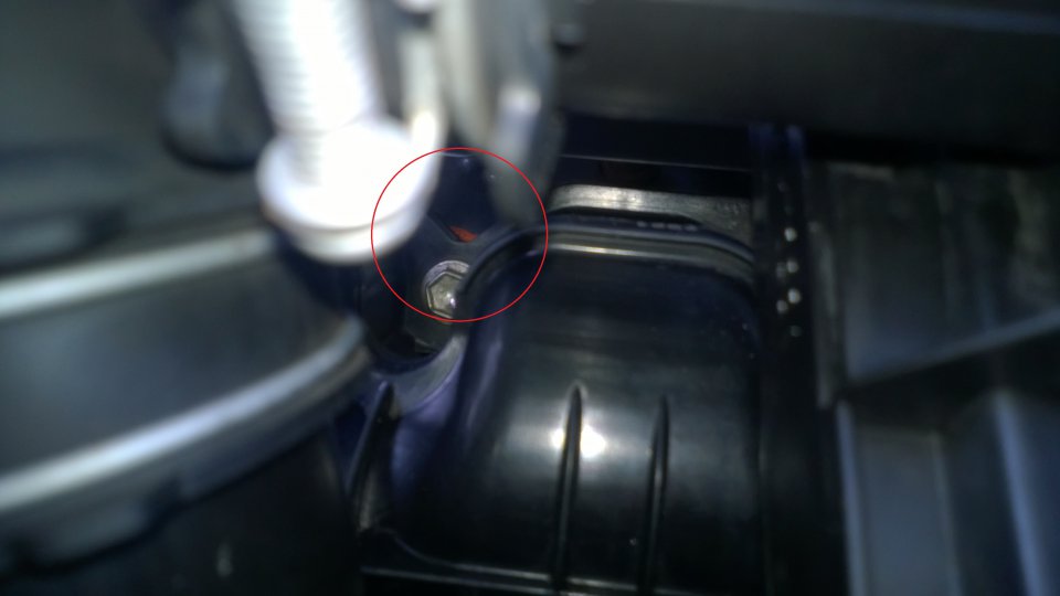

    Today, I did notice something in-between the intake manifold and engine head (Orange color rubber part), i think it should be the manifold gasket but I am not too sure whether this is normal and causing the error.

    That's the gasket and its normal, if you want to try locating a intake leak (not a common problem), you can try spraying carburetor cleaner around the intake area and listen for a idle surge (engine running of course).
    I would try cleaning the maf sensor with CRC maf cleaner, its located on the upper right hand corner of this picture of the air box.

    I had 2003 corolla with the same problem and had to replace the intake gasket to fix it. However, it was a very common problem in that car as they used a defective gasket in the factory. Since it's a rare issue in Prius, the problem or may or may not be the intake gasket. While the gasket is cheap, it takes some time to replace it. You need to check/clean MAF, check for any intake leakes downstream to MAF and any exhaust leaks upstream to oxygen sensor first before attempting to replace the gasket.

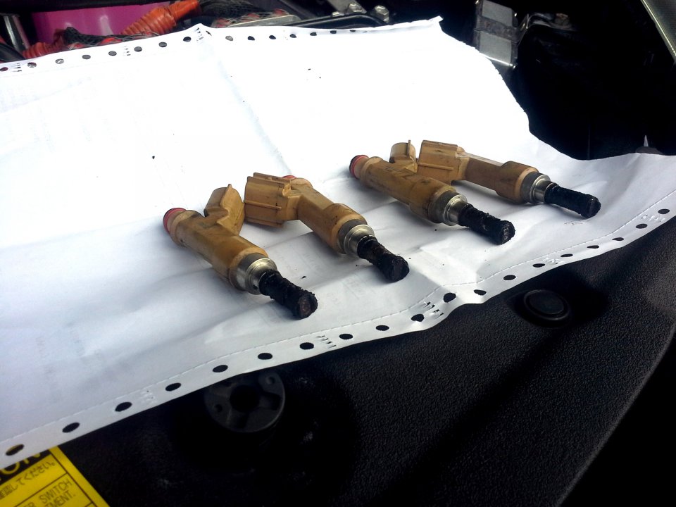

    I think i have found the problem which is really an unexpected situation at this level of millage of my Gen III prius (2010 - 62,000 Km).... i never thought that fuel injectors can be blocked this early. 20141213_093312.jpg

    you must get some seriously bad fuel down there. is there a fuel filter? i wonder if a bottle of fuel treatment every now and again would be helpful?

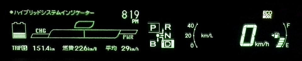

    Soon after cleaning the injectors, the engine started to perform like a new, no error codes anymore Got the best millage after longtime 22.6kml (53+ MPG) in regular driving...!!!

    Wow. Better pictures of the pintle area of the injectors please. They look really dirty. Maybe byproduct of the EGR sludge? That EGR sludge is a known issue and man it gets really clogged up doesn't it? So maybe good idea if you clean the EGR take a look at the pintles also. Very good stuff thank you.
    Don't understand why no misfire though. That will throw you off the path for sure.
    Good find!

    I'm wondering if the badly clogged EGR could be the cause of the clogging injectors. Clogging EGR is starting to look like a regular, inevitable issue with 3rd gen.

    It is interesting to see the RHD JDM model display in your photo is the mirror image of the LHD North American display with regards to the location of the fuel gauge and speedometer, vs. the hybrid drivetrain power indicator and traction battery state of charge gauge.
